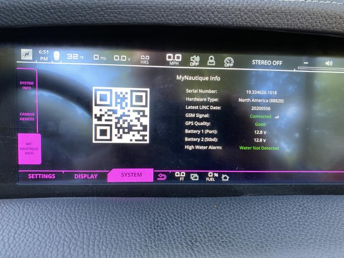

                            I was just looking around in LINC, and found this screen that shows the signal strength for GSM and GPS quality.
                            I'd be interested to see what this screen looks like for those of you experiencing issues.

                            • RDT-G23
                              • Jun 2017
                              • 589
                              • TEXAS
                              • 2020 G23 PARAGON I 2017 G23(sold)
                              #59
                              I will check this next weekend.
                                Mine is updating but not very frequently. Yesterday I checked it and based on engine hours it was 1.5 hours without an update. I wish they would have a force update or as others mentioned a time stamp at least.
