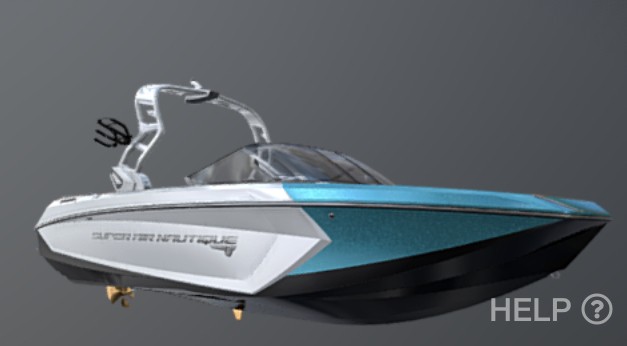

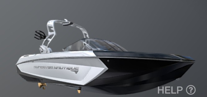

    Anyone know of a place to get a quality metalflake vinyl? I love my 2015 G23 but I’d like to change it up a bit. The front section of my boat is plain black but I’d like something blue up front. The all white and black boat is what mine looks like, the one with reef blue is what I’d like to do

    I’d imagine any quality local vinyl wrap company could do that to your boat no problem, try googling local vinyl wraps, there’s got to be a few around you.

        I've done a wrap on my '89 sn2001 and it held up very well, at 6 years there are a few scuffs and dings but nothing you'd see from 4' away. Get an extra foot or two or keep some off cuts, small round patches can cover up any dings and blend in near seamlessly.
        The vvivid liquid metal aqua blue might be a close match to what you're looking for.

          That looks really close to what I’m looking for. Does it actually look deep like a gel coat?

                I do wraps for a living, don't mess with vivid vinyl. its garbage. Your best bet would be Avery Dennison "diamond" line. Unfortunatley they don't have a color like the reef flake but they do have one very similar to masters blue flake.
