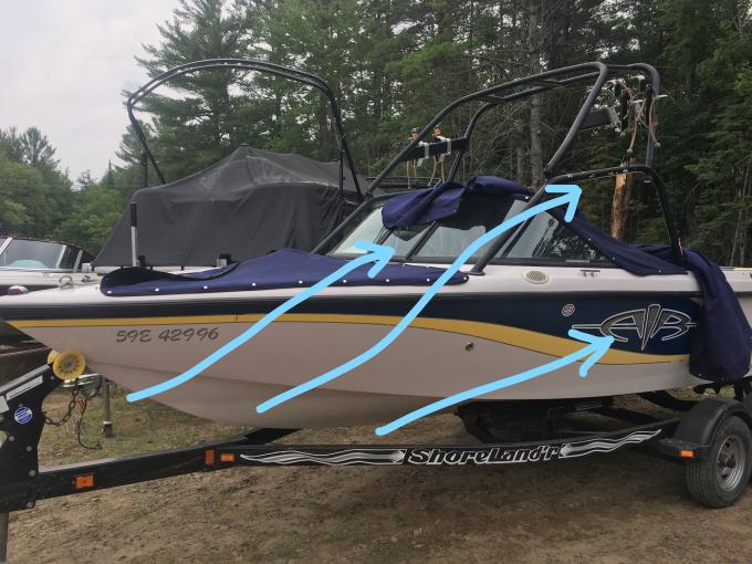

I removed pinstriping and main graphic in blue area. It looks to plain now and slight fade in blue gel coat is noticeable. Do I put back same graphic or would a more modern one work? In addition can I buy a complete window door replacement? Locks are broken off and frame is showing wear.
The original graphic is the only one that will fit properly on an '03. You should buff the gelcoat to get rid of the fading before installing the new graphic.

For the door, I would just pull it apart and have the frame powder coated. It'll look brand new.Please do not PM me directly asking for advice on how to repair your boat. While I would love to help everyone, I simply do not have time to respond to all of the inquiries. Please post your questions on the forum, so that all of our members have a chance to answer.
I'm going to be trying the more modern decaling on my 2002 SANTE in the spring, Ive ordered 3" domed letters and will see how they look, I've only got a two colour hull (grey and blue) It seems to look good in my head but we'll see haha,, if it doesnt seem to fit well anywhere I may do a partial wrap from the grey swoop to the back...

I think as long as you do a contrasting color for the graphic you could get away with just about anything.
From a fading perspective..... cross blocking the affected area as well as about 2' all around it should greatly diminish the effects of fading around the decal. I start with with 1200 and work my way up to 2000 using a block to make sure I don't grove the surface in the process. I then move to the 3 step 3M paint finishing system products to finish off the surface and bring out the gel coat gloss.

That won't work on an '03. The color stripes are not the same.Please do not PM me directly asking for advice on how to repair your boat. While I would love to help everyone, I simply do not have time to respond to all of the inquiries. Please post your questions on the forum, so that all of our members have a chance to answer.
Cross blocking is a sanding technique that you use when looking to flatten or blend an area. This is something typically seen in auto body but translates well with most finishing techniques. What you're basically looking to do (as I've been taught) is to take a 45 degree angle on the area you're working then approach the same area from an opposite 45 degree angle. When working with gel coat, since it's so soft I personally like to start blocking using a rubber sanding block thats' about 4" x 4" with the lightest grit paper that I can work with and still achieve the desired results even if that means working longer to achieve the desired result. The idea is to take the minimum amount of material off to achieve the final result. Using a rubber sanding block will keep you from putting groves in the gelcoat with your fingers as you sand the surface.Originally posted by Alcottawa View PostBturner, when you say cross blocking is that a sanding technique to feather it out a bit?
