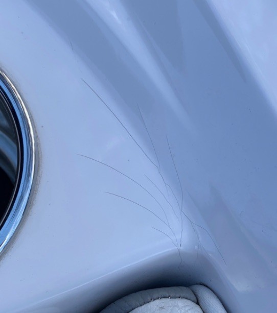

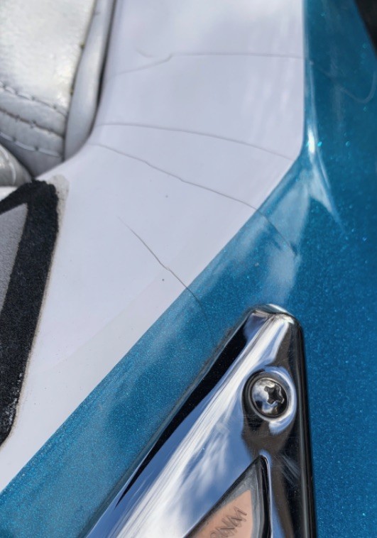

    Hi,
    Starting to shop for a used G23.
    Anyone seen gelcoat stress cracks at top outer of corner of trimaran hull? This would be early - 2013. And adjacent to the corner lights and top forward sea deck pad.
    Don’t look like an structural issue to me but thought I’d query those with real knowledge.
    Thanks
    DW

    I haven't heard of that being a common issue. Got any pictures?

      Thank you. I added a few photos here:

                    I was going to say maybe they hit a dock or something based on the location, but usually there would be a noticeable central point from which the cracks originate and spread from... that’s not the case in either of your pics. Might just be a strange weak spot in the layup that’s caused some cosmetic cracks. Any decent fiberglass repair guy should be able to grind out the cracks and repair them without issue.

                      My 2013 has similar cracks in the exact same location. Depends a lot on the climate the boat is in as well. In Canada we have like 50 degree swings in temperature that happen rather quickly. Cosmetic only and can be repaired if you don’t like the look of them. But they will probably reappear after a short while.

                        I've seen cracks like these in couple boats MC X1s on our lake that were way sacked out with lead bags added as well. There are a lot of factors but crazy ballast certainly doesn't help.
                        Oh and both the boats that I saw were used by the same group of teenage boys on the lake. They beat the heck out of those boats (and their dirt bikes, jet skis, wakeboards, tubes etc. etc. ......) but boys will be boys especially if they have no respect for the toys they're given.

                            Could be. I don't know. I think I have about as many really stupid production issues on both my 2008 210, and 2014 g21. But it would be interesting to know from a fiberglass export if there what if any correlation there is between workmanship and spider cracks or if more about temperature swings, or other issues (thickness or prep or something).
