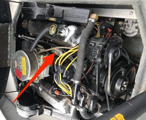

Which engine is this? 260hp or 290hp? How can you tell? This is on a 1998 Ski nautique closed bow. Sorry the photo is sideways, couldn’t get it to flip. Thanks!
Once you read the tag the first three letters of the model will tell you if you look in this engine book on this web site.

Start looking on page SP1
https://www.planetnautique.com/Corre...T-40Manual.pdf
1998 SN GT40

The GT-40 is a great engine, but there's certainly nothing wrong with that one. I have had similar ones go over 2,000 hours with no issues at all.Please do not PM me directly asking for advice on how to repair your boat. While I would love to help everyone, I simply do not have time to respond to all of the inquiries. Please post your questions on the forum, so that all of our members have a chance to answer.
