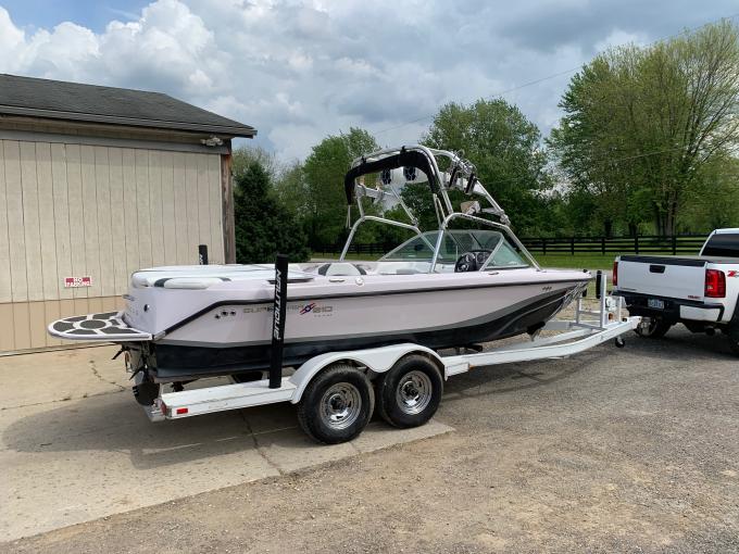

    I just got mostly done with the restoration ( hard to say that about a 2005 boat ) of my 2005 SANTE. Wanted to see what else people are doing to make this boat the best it can be. Any recommendations are welcome.
    Here is what I have done so far:
    New Interior ( All Pieces Recovered )
    New Steering Cable
    New Bow Light
    New Tower Anchor Light
    New Byerly Faria Guages ( Previous Owner )
    New Flight Clip Bungies
    Hand Buffed and Waxed Hull ( might still need a little work )
    Stock Ballast ( I have Rear SACS for the Wedge Tanks / Bow V SAC )
    Stock Prop
    New Rockford RX5000 Head Unit / Dash Remote / Transom Remote
    2 Rockford Amps ( P1000X5 for Boat, P600X4 Bridged for Tower )
    6 Wet Sounds Revo 6 Interior Speakers
    Pair Wet Sounds Rev10 Tower Speakers w/ LED Rings
    Wet Sounds WS420 EQ
    12" Kicker Solo-Baric Sub
    LED Controller

    Hard to think of anything else that boat might need. Looks to me like you have it well sorted.
