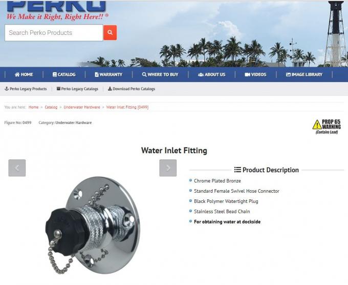

          I don't have an image handy but on my 2017 G23 Coastal Edition , it is literally a female brass garden hose end fitting just on the outside of the engine divider then a hose which has an open and close 90 degree handle. Very simple system
          Yes, simple but that's not the whole story, it goes from the back of the boat to shutoff (as mentioned above) by hose to a brass tee between the strainer and i believe the raw water pump. You gonna need that part...maybe nautiqueparts has it.

                        I tried tracing the T handle hose and it ending up going below the Vdrive area in which I could not see the hose anymore. Somehow it has to T into strainer hose but I gave up . Nonetheless here is the part you need from Perko
                        http://www.skidim.com/FLUSH-PRO-1/productinfo/DP6/
                        • scottb7
                          • Aug 2011
                          • 2198
                          • Carson City, Nevada
                          No that is not it. That is what is used when you don't use the handle shut off. That one is more automated but less reliable. Not what Nautique uses.
