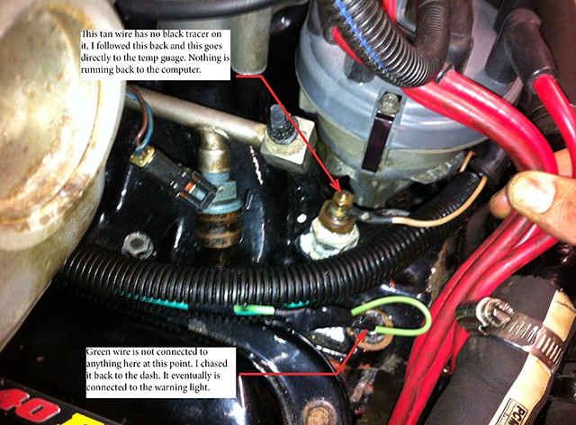

The engine temperature water gauge needle is pegged all the way to the right, ignition, off or on, engine cold or hot. Any trouble shooting ideas?
Probably a gauge failure, but let's check first.
Disconnect the wire on the temperature sender on the engine. The gauge should go to cold.
Ground that wire to the engine block. The gauge should go to full hot.
If doing those things works, it isn't the gauge, it is the temperature sender. If doing those things doesn't change anything, it is the gauge.
Since you said it stays pegged even with the ignition off, I am betting on the gauge being bad.
