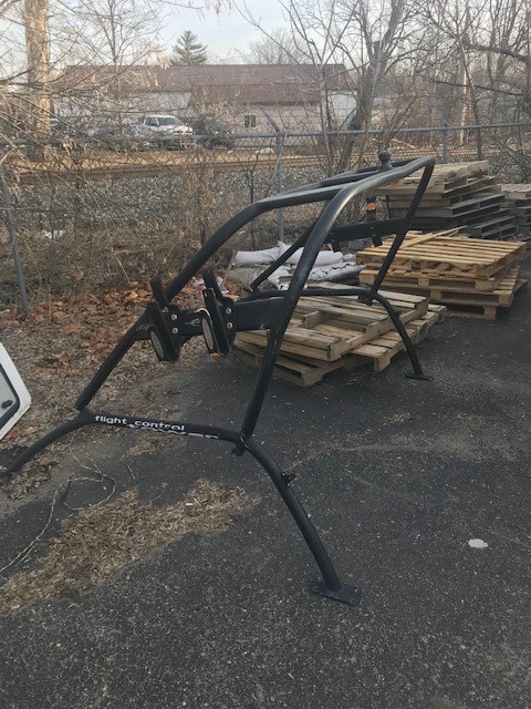

Hey guys, need some help on tower parts. The tower I just got is missing some hardware. Came off an older 210. I need the bolts that are on the tower hinges when folded (it's missing one), the knobs to release the tower for folding, and the mounting screws/bolts. I tried Wayne at NDT but said they weren't the manufacturer of that tower. Any guidance? Checked NautiqueParts but didn't see anything. Pic below. Sorry, no idea why it's sideways. <--- Fixed by admin

not sure on hardware but I’d give Townsend a call at NP. Or email him the pictures of hardware you need, he could point good in the right direction I believe.2009 Super Air Nautique 210 TE

Thanks Scooter. Is this FCT2? I hate asking this but I'd like to know for future accessories.
Also, to replace these do I just "bang em out" with like a dowel and mallet? Anyone know?
It’s an FCT 2nd gen
here is a great link identifying the different towers.
https://www.planetnautique.com/vb5/f...control-towers2009 Super Air Nautique 210 TE
1989 Sport Nautique
Shouldn’t have to bang them out, they are threaded in the upper section and e-clips hold them in the bottom section. You can see the clip in the NP photo of knobs.2009 Super Air Nautique 210 TE
1989 Sport Nautique
Cool thanks again. I swear I have the worst luck with search boxes. Never work for me. Left a message for NP to call me regarding hardware. Tower currently getting sandblasted and powder coated.

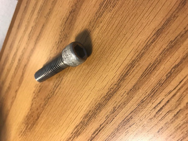

Thanks Jeff. Got it. Hey, what type of bolts do I want to attach the tower to the fiberglass and backing plate? Any idea on thread or bolt length? Looks like I'm going to be on my own for these as NP doesn't have them. The bolt on the hinged portion I have one of and will just find another, shouldn't be too hard. Question on that hinged alan bolt...is there supposed to be any type of "nut" on the other side or does it just pressure fit. I'll attach a pic of what I have for the hinge bolt.
There is not a nut that holds the socket head cap screw. It should thread from the outside to the inside and thread into the inner part of the tower frame. You should be able to at least determine the size and thread pitch and order a stainless steel on from somewhere.
As for the tower to the boat, it should be with stainless bolts, washers and nylock nuts on the bottom of the gunnel. I don’t remember the sizes for those.
I just went though all of this. Yes it’s a FCT2. The knobbed bolts have a c clip that you’ll need snap ring pliers to remove. You get access to that from above once you take the upper portion off. Take any bolts and washers to a local Fastenal or hardware store and they can get you fixed up with new stainless hardware.
An no there is not a nut for the bolt you pictured. It just threads into the tower.
