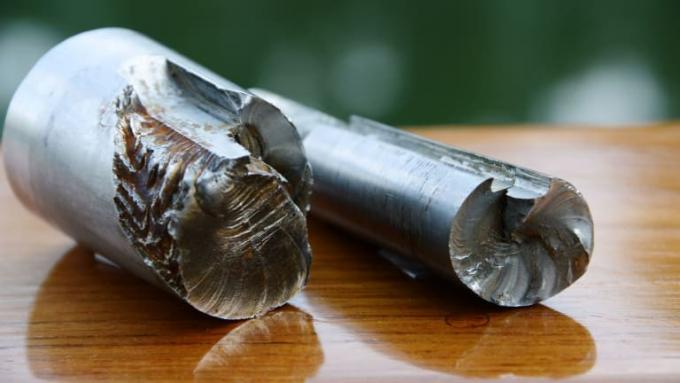

              A propeller shaft experiences four forces: 1) Compression, 2)Torsional, 3)Bending, 4) Tension. The compression force is the force of the prop pushing along the axis of the shaft to move the boat. It would take a MASSIVE compression force to compress the shaft along its longitudinal axis to cause it to fail. Propeller shaft failures are well studied and there are MANY reports analyzing why these failures occur. Do a google search for: Boat Propeller Shaft Failure Analysis". Compression failures almost never occur. See: https://reliabilityweb.com/articles/...and_prevention and https://www.efficientplantmag.com/20...achine-shafts/
              Next is torsional force failures. Torsional force is the rotational force applied by the engine to rotate the propeller shaft. Torsional forces also occur when the propeller is rapidly shifted from forward to reverse or it strikes an object. Torsional forces cause a failure along the shafts longitudinal axis. Torsional failures have a very distinct failure mode compared to compression and bending failures. These failures are indicated by a ragged, starburst pattern along the axis of the shaft. A good way to think of this is to take a clump of dry spaghetti, hold it by the ends in each hand. Then apply a twisting force on it until the spaghetti fails. The resulting failure mode can happen anywhere along the length of the shaft and will have a jagged, angular failure profile. This has NOT been observed on any of the shafts that have failed.
              Here is an image of a torsional load induced shaft failure.
Name:	Torsional Shaft Failure.jpg
              Go back and look at the pictures of the broken G shafts. They ALL have a clean, roughly 90 degree failure profile. Now take that spaghetti and hold it with both hands close together, and bend your hands until the spaghetti snaps. It will fail with a relatively clean 90 degree fracture.
              A clean 90 degree failure positively indicates a bending force. It will also occur right at the strut, the point of support for the bending force. Remember my example of an engine with a 10' shaft and a 500 lb weight placed on end? Where would it fail? Exactly at the point of support, in this case the strut.
              I'm adding the Tension force for completeness, but clearly the shafts are not failing because the prop is placing a critical tension force on the shaft. I would hope this is obvious.
              In summary, once again here is the G shaft failure picture. And there are many others in the various posts about G shaft failures. THEY ALL OCCUR AT OR NEAR THE STRUT, have a clean 90 degree failure mode, and they have all occurred because the key way was cut too long producing a weak point at the point of the greatest bending force, the strut. This is confirming evidence of a bending failure. The prop shaft is being bent by the asymmetric forces applied by the yaw of the boat and the angle of the prop shaft.
              If the boat were always driven straight, the prop shaft were parallel to the water flow, this failure would never occur. But that is not the case.

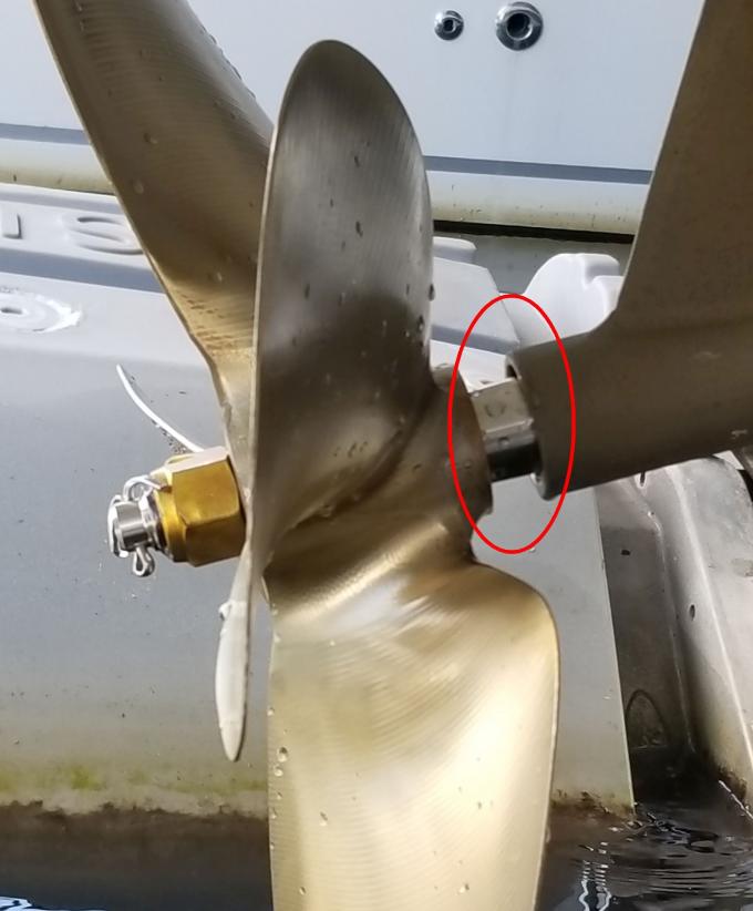

                              cptotr That is a VERY insightful observation. Last year I performed measurements for ACME Propellers. They sent me several propellers to experiment with to determine performance while surfing and I provided them a spreadsheet of Top Speed, Surf Speed RPM, Fuel Consumption, Sound pressure levels etc,. You can find these measurements here: https://www.planetnautique.com/vb5/f...-ballast/page2
                              The two propellers with the most promise for the H6Di Engine on my G23 were the Acme #3087 17.5 x 17.5 and the Acme #3085 17.5 x 17 props. In both cases these props were 17.5" diameter. Since prop diameter is directly proportional to the bending forces these propellers were manufactured with a longer 3.375" prop hub as opposed to the 3" hub on the standard ACME # 2561 17 x 17 which is shipped on the G23.
                              When I discussed the increased hub length with ACME (because I needed a larger prop puller tool to remove them) they said it was done to increase the contact of the propeller with the shaft and to reduce the moment on the shaft from the increased bending forces of the larger diameter props. The 17.5 x 17.5 prop was the one installed on my boat when the propeller shaft failed from bending fatigue. It had a 3.375" hub, but that was insufficient to distribute the bending forces of the larger diameter prop with the defective shaft. However, I believe that a 3.375" hub using the standard 17" diameter would be less likely to fail than a prop using a 3" hub for the reasons above. Hub length is yet another variable of why some shafts fail and others do not.
                              Here is a picture provided by Tallredrider of a shaft cut with the long key way and a standard 3" hub. You can see the .5" to .75" gap between the hub and the strut. You can also see the deep key way exposed up to the strut weakening the shaft at the point of greatest moment. To the best of my knowledge this long cut key way is present on ALL of the shafts that have failed on the 2018 Gs. HOWEVER, simply having this longer cut key way does not mean the shaft will definitely fail. There are metallurgy issues contributing to this failure as well. I have spoken to four owners of shaft failures and read about several on these forums. Most of the failures occur within the first 100 hours of surf use, which also confirms metallurgy defects because there are many of these shafts on boats with hundreds of hours that have not failed.

                              Here is a picture of the new shaft on my 2018 G that was replaced after the old one failed. There is no exposed key way past the 3" prop hub.
Name:	G23 New Prop Shaft.jpg

                                Marine propulsion shaft failures are nothing new. Do a Google search on that term and you will find over 800,000 hits. In large yachts such as the Hatteras shown in the video, the propellers are mounted as close to parallel with the water flow as possible to reduce the angle of attack of the blades and therefore reduce prop shaft bending forces. Large Yachts clearly don't have surf systems that yaw the boat and introduce bending forces on the shaft either. Shaft failures on large yachts occur primarily because of the very high torsional forces required to turn and reverse the large diameter props.
                                Failure analysis for prop shaft fractures is a VERY well established science. Failures are easily classified using the diagram below.
                                Click image for larger version  Name:	Shaft Failure Modes.jpg Views:	90 Size:	42.6 KB ID:	579616
                                If you look at the shaft failure in the Hatteras video you will see that the fracture plane of the crack is not 90 degrees but rather angular along the length of the shaft, similar to the Torsion failure plane example in the diagram above. This confirms excessive torsional loads.
                                The failures on all of the G23 shafts that I have posted and the others pictured in the numerous images in these forums are 90 degree fractures. This is indicative of BENDING forces on the shaft. These bending forces occur because of Yaw and Shaft Angle of the propeller, not torsional overload.
                                Finally, the new G shafts are cut with a rounded end in the key way to reduce this stress point. However, I have not seen a round key yet. I suspect that might be coming soon.
