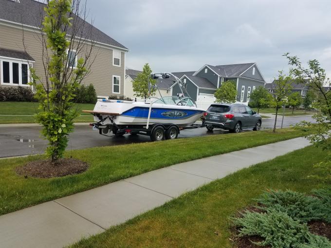

                I tow my 210 with a 2018 Nissan Pathfinder. Rated for 6000lbs. Would not recommend it!
