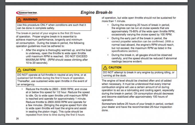

Here is what your owner's manual says, which is what you should actually do. My interpretation is to do what they say for the first 5 hours, then run it like you normally would, unless you sit idling for gobs of time, or have that surfer or wakeboard friend who rides for 20 minutes straight without falling.
For the first 5 hours break in the engine as prescribed in the manual. Avoid prolonged time at any fixed RPM or idle (regularly vary the throttle). We start surfing at 5+ hours. I change the oil between 6 and 10 hours. I've done this with 4 G23s putting 150 to 250 hours on each without issue.
