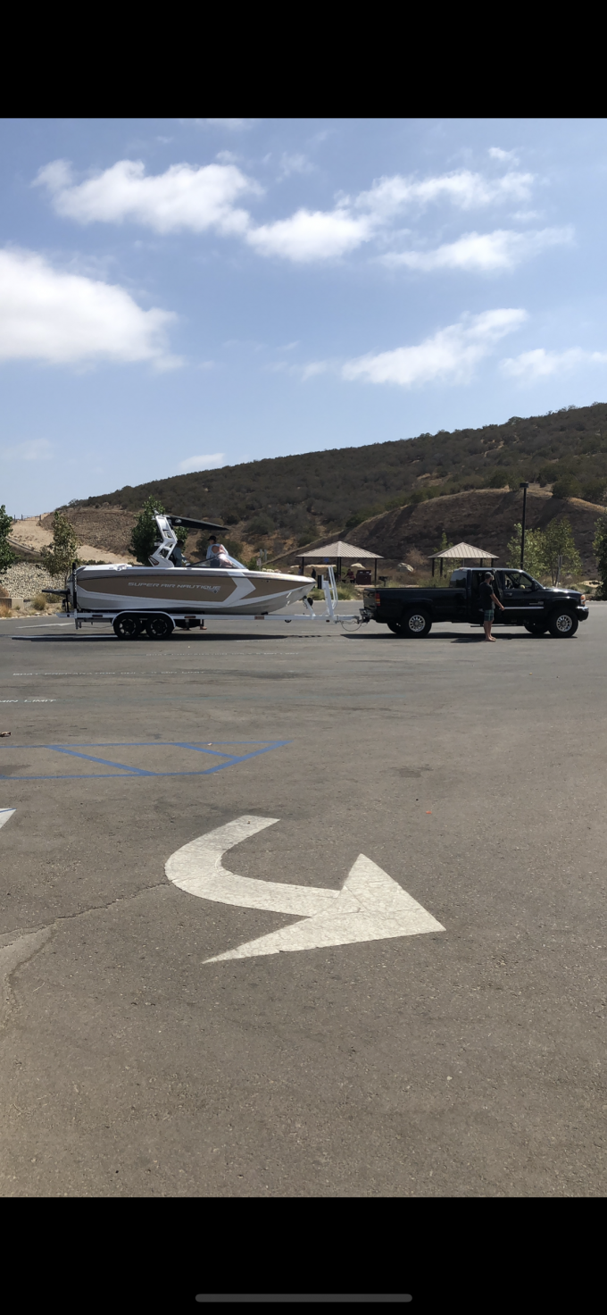

                    #39
ID:	568433 Click image for larger version
                    • thejean
                      • Aug 2017
                      • 364
                      • Calgary, AB
                      #40
                      Gorgeous colours!!!!
