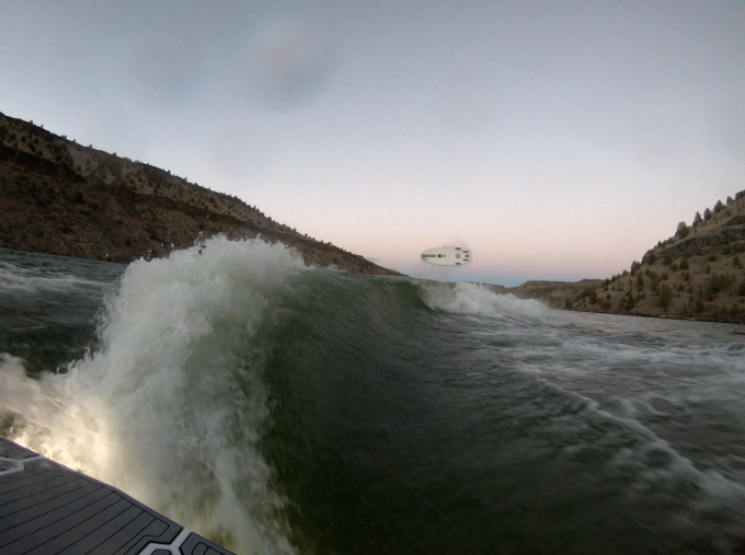

                Do you have a pic? Something sounds wrong here. We go 11.2 often with lighter riders with no issues.

                  Ya - Stock wave is great for us. Pic shows our wave with out of the box surf settings. We do have 600 pounds of lead distributed front to back evenly - 200 pounds biased to port - to make up for only having a couple people on the boat. Yes, that is a board floating above the wave.
                  Click image for larger version  Name:	Screen Shot 2018-07-09 at 9.48.35 AM.PNG Views:	1 Size:	446.7 KB ID:	567536
