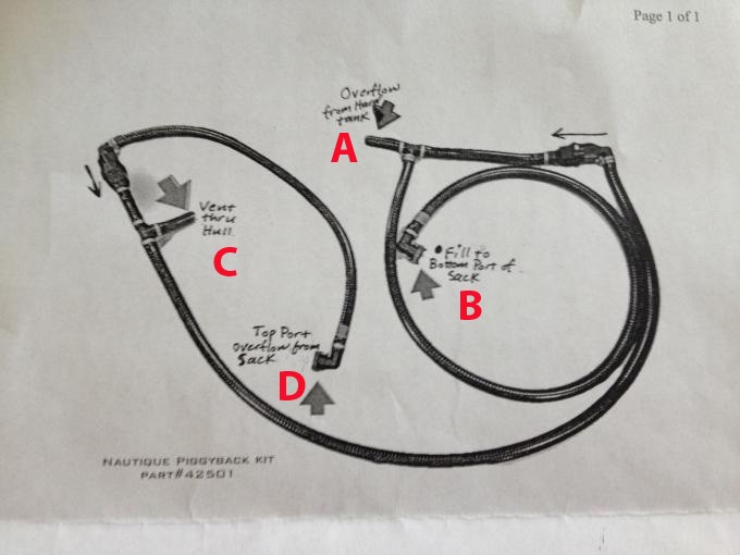

    Here's a picture of the hose for one side (port or starboard?).. ...a couple of questions:
    1. If A attaches to the factory hard tank overflow, why is the hose length from "A" to "B" about 4' long? It appears to me the distance between the hard tank overflow/vent and the rear facing/lower bag port is only about 12 inches.
    2. Once the factory vent line is removed from the hard tank overflow, I presume the factory vent line just connects to "C"? I'm curious why "C" has a short length of hose? Couldn't the factory vent line just connect directly to the "T" fitting?
    thanks

    It looks confusing because that diagram wants you to have a vent for the hard tank AND the fat sac. Reason is when piggybacking you run the risk of collapsing the hard tank due to the fat sac sucking so tight it doesn't allow venting when draining. This is why piggybacking SUCKS!
    The hose is probably so long so that the customer can choose to put the fat sac fitting at the very stern rather than where the hard tank fittings are located at the front of the tanks.
    What I do is rip those factory hard tanks out and put in a bigger fat sac, that way its SIMPLE, Hose in from the bottom hose out thru the top overflow. done. You also only need to buy the fittings (2 for each bag) and can reuse the factory hose. It works out CHEAPER and way more reliable.
    When its time to trade in or sell boat, remove fat sacs and place hard tanks back in. The removal/installation of the hard tanks is an absolute piece of cake on those boats.

      thanks for the insight...my hard tank fittings are at the stern which is what i was confused about since that hose is so long... I'm just getting into wake surfing so didn't know what I wanted/needed or i'd have ripped out the hard tanks...and i bought the sacs used at a good price so it was an easy decision vs removing the hard tanks.

          Do you have the step by step instructions? If so, then follow them literally and you should be fine. If not, then DM me with an email and I will send you a PDF with the step by step instructions I used on mine with out any issue. That said I did remove about 18” of hose from both sides after I determined the best way to run the lines. Hind sight, l should have pulled the hard tanks and used the 1100 lbs bags as I will likely be doing that during the off season.

            Okay - a follow up for those who run into the same issues. The hoses shipped with the kits from wavemakers must be used on many different model boats as the hose lengths are overkill for my application. I didn't bother cutting the hoses as I may sell the kit in the future but I did install the bags with the fill port towards the bow end of the storage bay which helped "eat up" the extra length of hose. Also, the factory hoses can be directly connected to the hose kit "T" connections.
