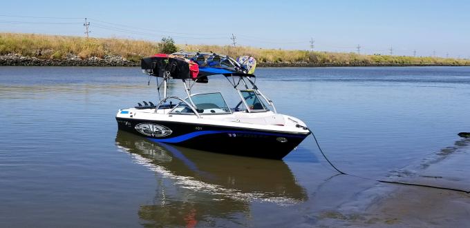

        I own an 04 I bought last summer from a single owner friend. It had 496 hours. I now have 610 hours and the motor runs great. I take it to a marine mechanic 1 time a year and get all the fluids changed. The boat has not left me stranded once since I have owned it. Boats getting toward 1K hours should be priced accordingly, if it were me I would be more comfortable at 5-600 hours on something used.
        The surf wave can be fun but I am a beginner and need a 500lb bow sac to finish up and bring my total ballast to 2500 lbs.
        I hear financing can be tougher on the older boats since they still have good value, I did a second off our house and got small loan at 4% interest.
        Now here is the list of things I have had to fix.... Heater core was likely leaking when I bought it, I didn't replace, just removed and linked the hoses together for now. Had to rip out all the rear ballast, it was stock and had a bad pump + the check valves were all bad which is totally common. But I added in 700 bags and reversible for about $1K and LOVE it now. New trailer tires was first on my list for safety and piece of mind, and the trailer breaks (disc) still need to be done, but its $700 to do the job which would be new hubs as well.
        In summary I LOVE my boat (don't mind the tower at all ), there are little things that will need work, but find one with good service records and a strong engine, + good interior. Those are the bigger expensive things that will run up your after purchase costs. Good luck with the search and feel free to ask me any questions. - Jason
