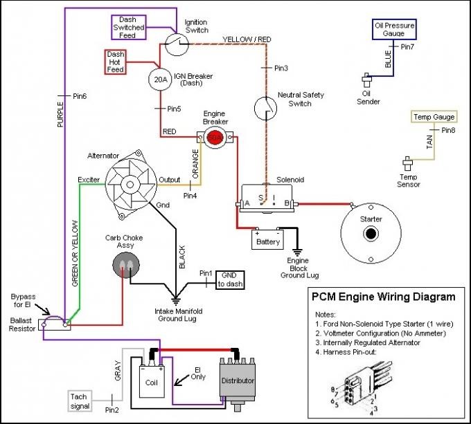

    this diagram may help you check to see if you wired wrong. I am not expert on such things, but went from three wire to one wire many years ago. Not because of price or preference or advantage, but because it was all I could find close by and I wanted to get back on the water. Its not really a "rewire", just hook up one of the three to the new alternator. Unfortunately, I cant tell you which of the three, but I am guessing its the orange.

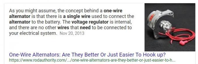

        I'm not expert but the original set up had an external regulator. I never did anything with it and assumed it was still functioning, but you are right, based on this little bit of research the 1-wire has internal. Maybe I bypassed the VR without knowing it by leaving off the two other wires that went to the original. Wires all pass through a harness, so never traced. Click image for larger version
