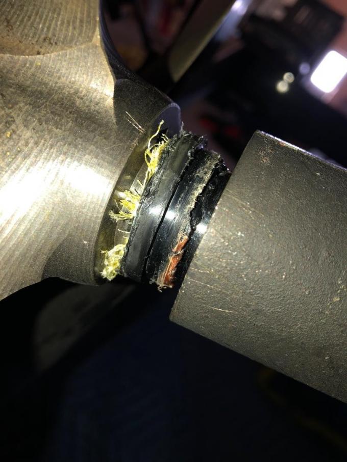

          Rockymtnsurfer, I would definitely confirm plugs gapped right, and wires all good still. However, the question about your prop, shaft, and bearing hasn't been fully addressed yet. Judging by your pic, it looks as though some line/rope has gotten wrapped around that shaft at some point. What you are calling the sleeve is I believe the bearing. It is called the bearing but does not have what you might think of as a "typical" bearing with metal balls or pins. It is only a piece of thermo plastic that as someone else mentioned has grooves in it for water passage to keep it cool when the shaft spins in it. The bearing SHOULD NOT be turning inside the brass strut. If that's the case, you need to stop running until you get that fixed or you may be wearing the metal on either the strut or shaft and in for more expensive parts. Get a new bearing (Nautique Parts), pull the prop, pull the shaft and replace. This could be a little over your head, but there's plenty of info on how to do this. I hope this helps.

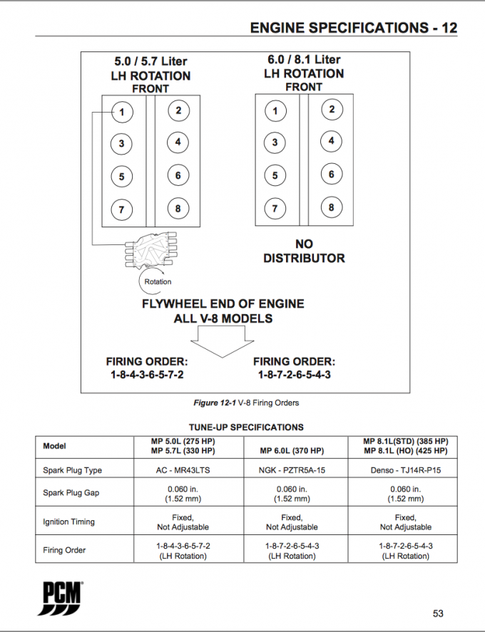

              Also...still trying to find the gap number for this chevy pcm 330 5.7l....not in the manual or I couldn't find it yet

                    found gap.....

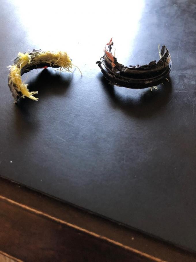

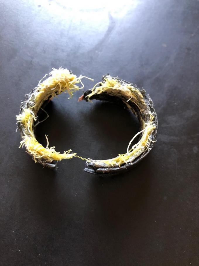

                      Whats your thoughts Homer......pics explain what I found today. I also see the bearing now from the rear view and it does NOT spin. Now that this piece I see is broken off, the rest of the bearing is not spinning either from the front view. obvious replace I believe........Do I just need the prop tool and the bearing? Housing seems fine and no angle wear. Maybe I should have PM you...sorry. D

                        I don't believe you need to do anything to the strut bearing... That looks like a piece of nylon rope that got stuck around the shaft and has possibly been that for awhile now. It's hard to tell from just pictures, but if your strut bearing is not spinning and there is no abnormal play between it and the shaft then I would call it good. I believe you're over-thinking some of this stuff and it sounds like you aren't the most mechanically inclined (no offense meant) so you worry about things that don't really need so much attention.
                        Now check you plug gaps, read the plugs for signs of a cylinder having trouble, test plug wires either by replacing with old or new, make sure you have spark at every plug. Your low power issue is most likely something small, but causes a big issue.

                            I thought that piece might have been the top cap of the bearing and now broken off......

                                Did gapping on plugs yesterday....all the plug were off .060............not sure if thats normal, but I am going to try and swing the boat to the lake today and seem what kind of improvement it did.
