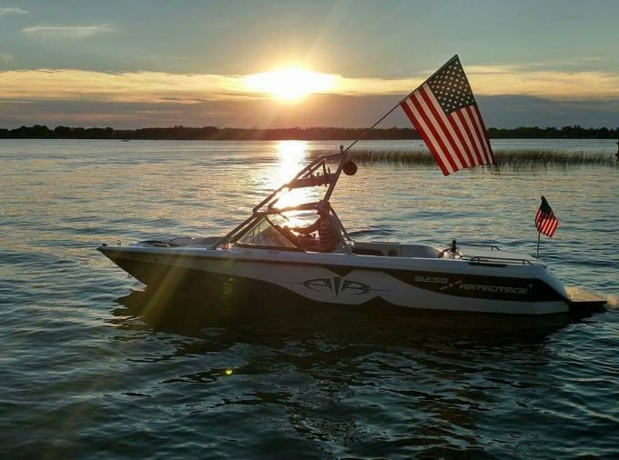

    Hey guys, long time lurker, first post. Trying to get my 2001 SAN surfing and have a few questions. I yanked the hard tanks and have been running 2 750's and a bow sac with a Swell shaper. I have been the only one surfing and have been unable to this point to drop the rope. Last time I had over 1,000 pound of people moving around to try and find a sweet spot but just not quite dialed. Wondering if I'm going too fast, initially started around 10 but thought it might be too slow so tried a couple tics faster but no luck, what am I missing? Do I have to list it? Have been running pretty even weight apart from moving big bodies. I have a phase 5 Hypsta cause I'm pretty big guy at about 215 lbs. Thanks a bunch guys, here's a pic for fun but I'll see if a buddy has one of the surf wake.

      Great pic! I also have a 99 Super Sport and I am using a homemade suck gate. I mainly wakeboard but when I surf I fill my rear 750s, 500ish in the belly locker and probably another 400 under the bow. I then usually list a little bit to the surf side with passenger weight. Where are you placing your wakeshaper? My suck gate is fixed at 90 degrees but I put it on the leading edge of the taper so that reduces the angle to probably 70% or so. Not sure that last sentence makes sense. Near the stern of the boat where it tapers in toward the platform, I place the front edge of my gate right where the taper begins. I also try to line it up that it is slightly above or even with the water line. Set it too low and you lose some of the wave. Playing around with your shaper might help things. Also, the sweet spot of the wave on this boat is pretty close to the platform unfortunately. You can certainly surf ropeless but it's hard to recover from way back.
