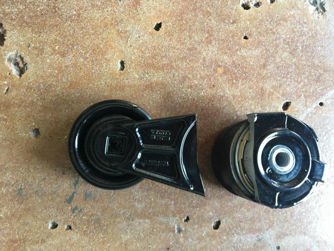

          And the winner is?... It is a broken belt tensioner... (I obviously didn't lean over the engine to look) The impeller was fine, but we are replacing it as well. Judging from the forum, the tensioners have been quite suspect... All I need now is a broken prop shaft, and I can score the exacta!...

            You would think a part as simple as a belt tensioner would last long that 37hrs? Stuff happens but I too would be upset having to be towed back to the dock on a 100 thousand plus dollar boat with less than 40hrs on it.
              31.6 hrs...

                https://www.planetnautique.com/vb5/f...oken-tensioner
                The thread on this shows there was a service bulletin for a range of serial numbers. Wonder if the range included your boat?

                    Mine had the fuel line work (securing) done, but nothing with the belt tensioner. Nothing in the document discussed the tensioner. I'm going to visit with the dealer that dispatched the tech to do the fuel line work...
