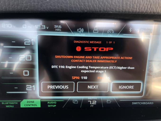

    Read my story. I ordered my boat last March or so. i went to the factory to see it 3/4 done. Nautique failed to tell me they had destroyed my hull, as it was faulty. To their credit, they flew me out the following week to see my replacement boat. Take delivery at the end of last June. Boat is missing a port catalyst. Codes, of course. I have 31.8 sweet, loving, no stress hours on her, and today she overheats. Makes all kind of racket, and throws a code-posted below. I have built and re-built at least 5 engines. I’ve raced cars all through my life. I’m a 12+ year Cobalt owner. I know very well about impellers. My frigging boat isn’t one year old yet! Get ready, Nautique-this won’t be pretty. I’ve had it with this **** boat.

      Check the belt. See if the tensioner, or one of the other pulleys, failed.

          Of course many of us are curious - keep us posted. Like blueroom says check belt/tensioner. They did have some bad tensioners so it could have broken. https://www.planetnautique.com/vb5/f...oken-tensioner

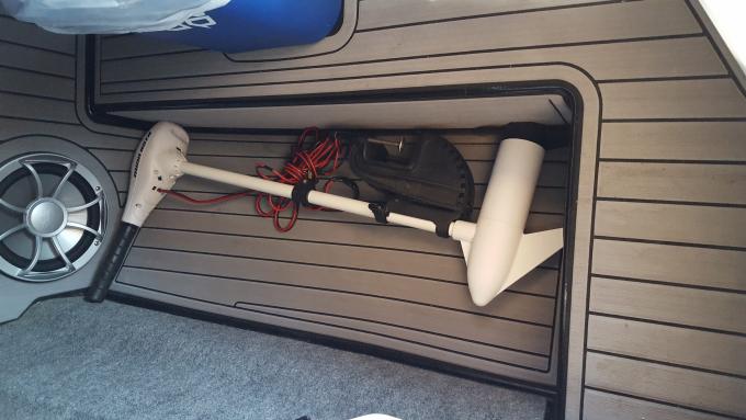

          P.S. There is a reason that under my loveseat it looks like this. Former owner, after prop shaft broke carried this around with good reason. Figure with 2 batteries I will never be stranded. Too bad trolling motor not offered in "masters blue". Then it would match my boat.
          Click image for larger version  Name:	Trolling motor.jpg Views:	1 Size:	40.1 KB ID:	557346

              Had same issue in mine .
              Do me a favor and take the strainer off (if you have one ) mine got cracked during winterization . It won’t leak much but sucks air .
              Same code as yours .
              I’m not sure if yours is same setup as mine . But I unscrewed it and it had a hair line crack in it . Problem solved in 30 minutes if so

                  Thanks, guys. I will look at the strainer.

                      Agreed. Right now you're mad and I get it. Tomorrow when you've settled down a bit get out there and do some troubleshooting. It could easily be something simple. Like the cracked strainer that Lucky described. Or maybe the strainer cup is just loose. I have no idea why, but they're NOT easy to get on without crossthreading. Or you could have sucked up a plastic bag. There are a lot of possibilities.
