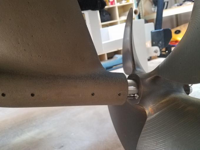

                      On the last day of testing the 17.5" x 17.5" prop the shaft failed and the prop fell into 60 feet of water. I never had a chance to test the 17.5" x 17. But I believe it would have been ideal for my needs ( best fuel efficiency and low engine noise). After the shock of having the shaft fail, I didn't want to mess around with new props. Since then I have learned much about shaft failures that occurred on the 2018 G23s. These particular failures were due to the key way being cut too long.
                      To identify the defective shafts on a 2018 G look at the shaft on the forward side of your prop hub. Rotate the prop to see the entire shaft. The affected shafts have the key way protruding about 1/4" beyond the prop hub. I would be hesitant to increase prop diameter with these shafts. Otherwise in my opinion the 17.5" x 17" prop would be ideal for an H6Di G23.

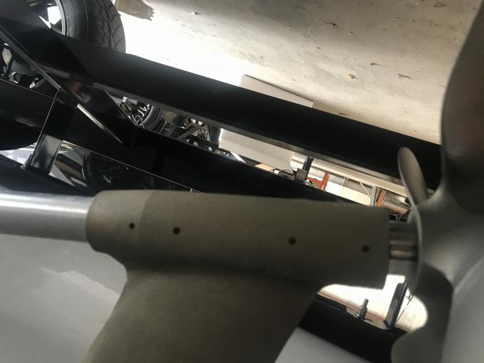

                            Gregg, thanks for the quick feedback - I have also been seeing the threads on shaft breakage and it was one of the reasons was looking to keep as close to stock as possible while still hoping to achieve some noise (primary) and gph (secondary) gains. Perhaps I'll give the 17.5" a try - looks like Acme has it labeled as the 3085
                            I will have a chance to take a look at the shaft tomorrow when I drop off my 210 and will investigate the keyway - appreciate the info

                              #44
                              Checked out my boat today and based on the attached picture suppose I would at least be in the lower risk category of shaft shear but feedback welcome
                              the keyway appears to end right at aft end of strut and definitely does not extends to forward side
                              apoogies - pic seems to be upside down and don’t know how to rotate

                                #45
                                greggmck, do you mean the keyway, or the key itself? My key is placed just inside the hub, but the carved keyway goes up quite a ways beyond.
                                My key ends at the prop hub, but the shaft has a groove that extends quite a long ways.
                                It almost looks like the key is not squarely placed into the keyway...I don't dare mess with it, since it has served me well for 337 hours now.
                                Click image for larger version  Name:	20180923_121842.jpg Views:	1 Size:	32.4 KB ID:	569043
