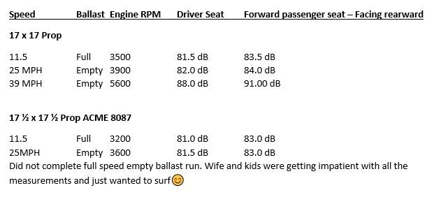

                  Boat 2018 G23 H6DI
                  Conditions: Sea level. Air temp: 73 degrees. Water temp: 68 degrees.
                  Four persons including driver: Two Adults, Two teenagers
                  Total people weight 550 lbs. – All sitting on surf side (except driver on Goofy).
                  Fuel - Full to 80% for all measurements
                  Lead ballast – total 900lbs.
                  Port side: 200lbs rear locker, 200lbs middle seat, 200lbs bow.
                  Starboard side: 100lbs rear locker, 100lbs middle seat, 100lbs bow.
                  Click image for larger version  Name:	Temp.JPG Views:	1 Size:	36.3 KB ID:	555863
                  Noticeable Changes:
                  Dead slow is 1.5mph faster - Was 3 mph now is 4.5 mph
                  Boat seams quieter while surfing behind the boat. I can hear the music more clearly.
                  Surf wave is very clean and identical with both props.
                  Surf List angle: Port side is 1-2 degrees, Starboard side 4-5 degrees (identical for both props)
                  The boat accelerates slightly more slowly. But it does not seem to struggle. I ran up to 28MPH with full ballast and it did not have any problems. In summary, I am very satisfied with the propeller and would recommend. But I would NOT suggest going to a steeper pitch/larger prop with the H6DI. I would not want to put any more load on the engine. I need a few weeks to accurately measure fuel burn.

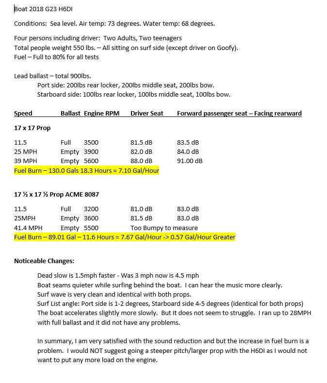

                    Update. Fuel burn is .6 Gal/hour greater with the 17 1/2 x 17 1/2 compared to stock 17 x 17. Not what I want or expected.

                      Very good detailed info. Thanks for sharing

                        I know I just took an intellectual beatdown for mentioning this might happen, but given the results, I would like someone to explain again why my truck pulling the boat gets significantly less MPG at the same RPM as I do when not towing. I know the explanation made some sense, but I now have renewed doubts. (OK, it wasn't a beatdown, they were very nice about saying that it was impossible to get lower mileage with lower RPM in a boat).
                        I am betting that the 17.5 X 17.5 is lugging the engine, even though it works. greggmck , did you by chance open it up full throttle and see if you can still reach the rev limiter? The guys at ACME suggest you are overpropped if you can't get the RPM's all the way to the top.

                          I have the same prop that I’m about to install this week, but no additional ballast from stock. I rarely surf with more than 6 in the boat (and many of them not very heavy). I’m looking for no change to surf conditions from a wave standpoint, but what I’m really seeking is something folks aren’t talking about... When I’m just driving the boat up the lake with my wife/guests in the evening, (no ballast or anything) I want to be able to cruise at 25 MPH without the doggone engine spinning that much. I came from a stern drive, and while I’m not trying to change my boat into something it is not designed to be, I would like a bit more civility in this instance...

                            I would add, when reading the data posted for the 3087 prop, that the fuel burn was measured while surfing with all of the associated representations for additional ballast. (that 900 lbs of lead is the equivalent of 4-225 individuals) A prop to me is like the rear end gear ratio on a vehicle. My 3/4 ton diesel runs great with a 3.55 gear, as I don’t pull crazy heavy loads. Others, who tow bigger loads that are closer to the specified max-would lug with my gear ratio. I’d argue the same here...

                              Yes. The full throttle speed is listed in the results. Full throttle RPM decreased by 100 RPM and speed increased. The lower RPM could have been due the fact that it was rougher conditions when we finally tested full throttle with the 17.5 x 17.5.

                                Yes. That was the whole point of the exercise. To lower the RPM and improve fuel burn while surfing. We train 250 - 300 hrs / season for surfing and don't care much about anything else.
