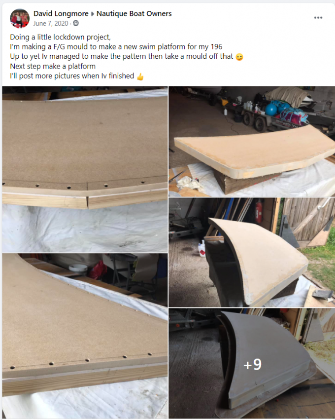

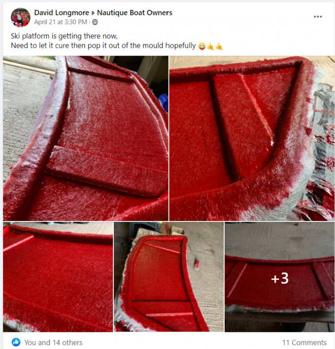

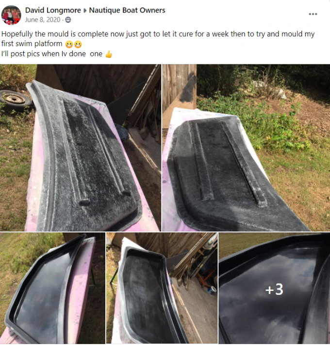

                  A fellow by the name of David Longmore has made a mold for fiberglass swim decks for his OG 196 on the Nautique Boat Owners FB group, wouldn't fit a 210 but the process would be the same:

                      It's probably a closed group. Here are screen shots:

                        Helpful! Thanks!
                        Board member wayoutthere could prolly give us a good summary of how much work it is to build a mold (aka 'buck'?) for a swimstep. I think he did basically the same process when he fabbed up the seats for his 2001 resto-mod project. I'm sure there are youtubes as well.

                          He did a nice job on that plug and mold, like to know the number of layers on the mold, it looks nice and thick, 5 maybe.
                          like to know how many layers and the type of coring on the part.
                          he used or finished off the part with mat, -------- it's a preference thing, i'd lay it up with 1708.-------
                          looks like that mold will/can reproduce many parts.
