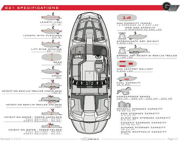

          I had this saved on my phone of a G21. Not sure how much difference in height it is from a G23. But its a start...Click image for larger version  Name:	G21Specs[1].png Views:	1 Size:	227.2 KB ID:	551233

            That is awesome! Where did you get this? I'd love to have this for my G23.

              Team230. I found it just by an internet search, so I could see if a G21 would fit in my garage. I just searched the same way for a G23 and couldn't find the same chart.

                Maybe someone from Nautique is viewing this thread? Nautique could easliy have a link on their website for all the boats in their fleet for owners and/or potential purchasers to pull up and download for their own use

                  ^ X2 on that as I struggled to get a "guess at best" on height of the G23 on a trailer with or without tower folded. Be real nice if factory or boatmate or such would make a chart for all models like @G posted above.
