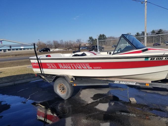

    Just bought this 89. Can I somehow restore the shine by wet sanding around the decals, then buffing with wax? trying to avoid replacing the decals... thoughts? or do you think a coat of wax would bring this back?

    Yea, it can be done but it's a time consuming process. The best thing you can do is tape over the decals. It's very difficult to wet-sand right up to the edge without sanding some of the decal edge off. Take your time and really get the tape perfect before you start.

      Tough to tell from that pic, does not look bad from here. Find your worst spot, try using a polish first, if not cutting it go to a heavy compound. After everything finish with a high quality paste wax like Collinite. Best products for job are 3M Heavy Duty Compound, Finesse-It, Perfect-It,

        Thanks guys, I might just try to wax it and see what happens. Good idea with the tape. Buffing I think would tear up the decals so I might end up just replacing them if I go that route.

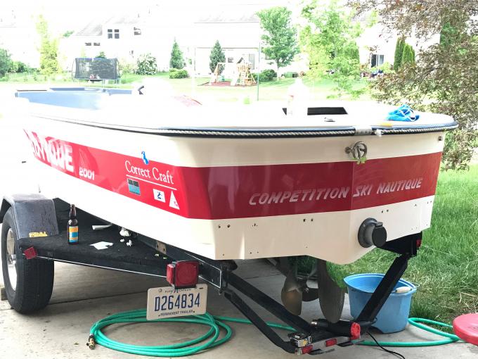

                      Just restored mine!!

                        Very Nice....... Did you add new decals or polish around the factory ones. We are going to start on my 89 this weekend. I am still not sure how to remove heavy oxidation between the letters.....Nice Job!

                          yes I stripped everything. Wetsanded the hull from 400 to 600 to 800 to 1000 and then 1200 grit. cut and polished it from there. It looks brand new but was without question a pile of work. In my opinion, polishing around the decals would be near impossible. Get a Marine 31 gelcoat restoration kit and give it ****. if your not happy with the results than your next step is the full resto.
