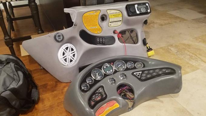

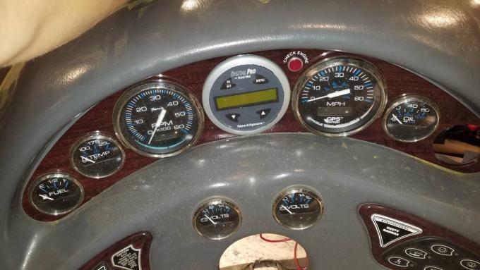

    • i own a 2001 super air nautique
    01 SAN woodgrain dash change
    Had anyone ever painted over the woodgrain dash and panel trim with success? I've updated all my gauges and I simply don't care for the look of the woodgrain. Want to go with just a gloss black. I think it's plastic.
    Sand/prep, plastic adhesion promoter, paint, clear. (Cans)???

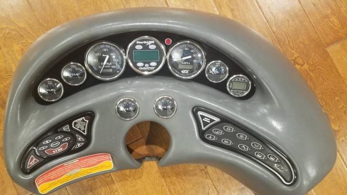

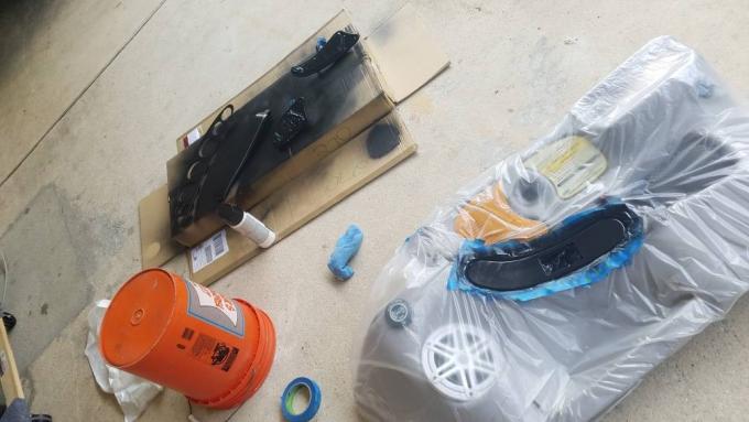

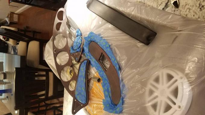

                      Decided to paint it at home. SEM Sand free ahesion promoter, 3 coats of Krylon Fusion, then a few clear coats
