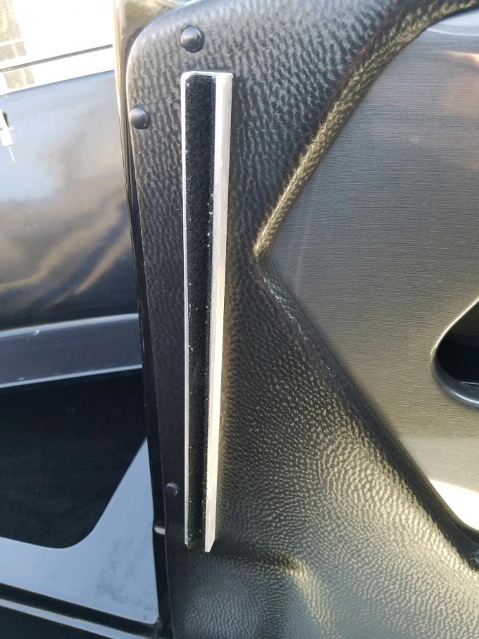

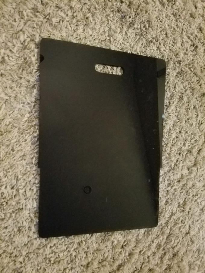

            I think you could add this. Making it look OEM in a 2017 may be a little more difficult, but easy solution is using C-channel on each side and then cutting a piece of HDPE or something else that slides in. If you want detailed pics of what mine looks like, let me know and I will send pics. I have different brand boat than you but same concept.

                • Infinity
                  • Sep 2017
                  • 730
                  • Lake Norman - Denver, NC
                  • 2014 SV244 w/ ZR409
                  Originally posted by Soul_surfer View Post
                  It’s exactly what I was expected to do.
                  sure if you want to share some pics it would surely help me !
                  thanks
                  I will get some pictures tomorrow when i get back from work

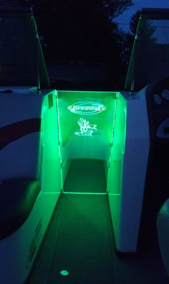

                        OR, you could always do a custom one! Here's a pic of one I made years ago for my 2007 Moomba Mobius LSV using some clear lexan, waterproof LED strips, and some strips cut from a Hydroturf pad (for the tracks). It actually worked great!! Used a Dremel to etch the pics onto the lexan!

                          Nice shot here !
                          bit as you said, the 210 isn’t exactly like G series.
                          and I’m not going to cut any upholstered panel that’s for sure.

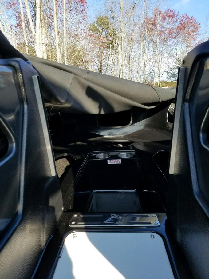

                          after further research i found some pics and like Charles said, the air dam is mold between the upholstery and plastic. When the option is not ordered it doesn’t have the U bar mold just after the upholstery.
                          But I can easily buy some galvanized U track and fix them on each side just after the upholstery and it’s gonna be perfect.
                          (mostly like you’ve done with your Moomba)

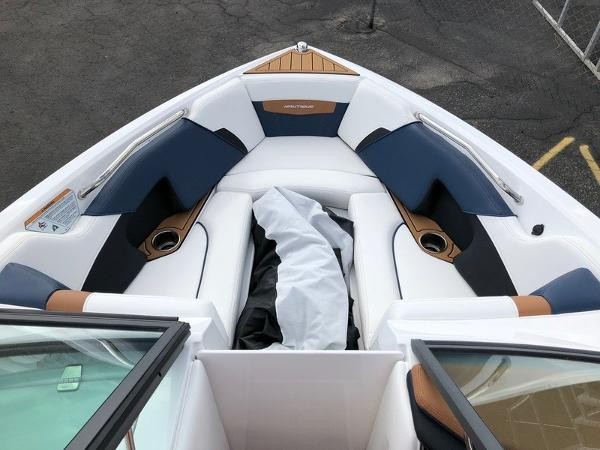

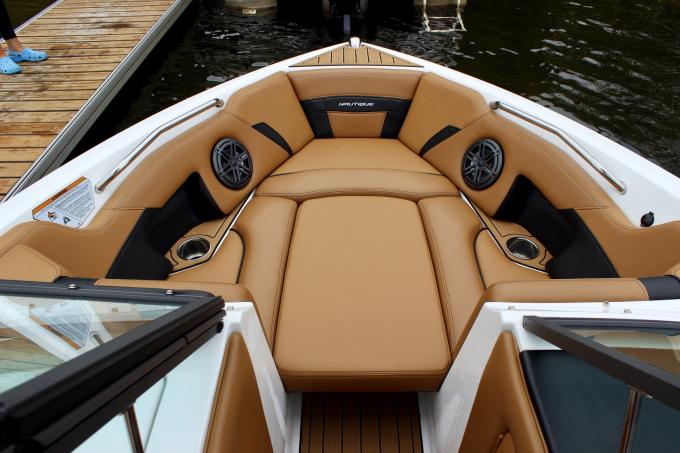

                          here’s some pic of a 210 with and mine without.
                          you can see that the U tracks are made to come flush with the rest but it’s not gonna bother me at all if I place my tracks above. Just need to take Slim tracks.

                            Here are some other closeup pics as promised
