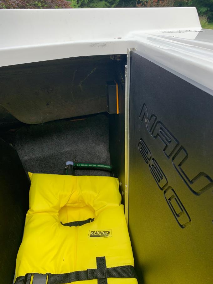

                      It is a hardware change. The Surf Select 3.0 module goes in the back of the boat on the Starboard side.
                      That is what that box is!!!!

                        Yep. There should be a little white sticker on the wires going to it listing the version number. There are 3 different ones:
                        1.2: Only on MY2016 boats with Surf Select installed from the factory.
                        2.0: MY2017-2019 boats
                        3.0: MY2020 boats. Supports the Garmin Fenix.

                          Is it as simple as replacing that box?

                            It was between 1.2 and 2.0. I do not yet know about 2.0 to 3.0. I have an inquiry in with my dealer and will update this thread as soon as I have more information.

                              OK, gang I have news!
                              - The Surf Select 3.0 module can be fitted on ANY 2016-2019 boat. It's already wired and the module can be installed easily.
                              - The LINC must be running the latest firmware. Most boats will require an update.
                              - The Surf Select 3.0 module is part number: 200169
                              - The Surf Select 3.0 module will run about $335 from your dealer.
