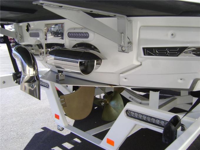

                  Originally posted by Bevostein View Post
                  Also someone with a thruster posted on here an issue with the exhaust bubbling up through the platform in a strange way. It was believed to be caused by the thruster somehow interfering with the exhaust flow.
                  As I recall, and I took a careful look at one at my dealership, the exhaust is ported out a different vent in the rear of the boat when the boat is idling. Otherwise the bubbles come up into the thruster and the thruster then becomes an air propeller, which really doesn't help. So yes, the surf pipe gets the shaft at idle speeds if you have a thruster. Just to prove I am not lazy, I found a picture. On the upper port side of the transom, just under the swimstep, next to the transom light, you can see the auxiliary exhaust port. The exhaust goes out there when your are idling.
                  This is what I understand, please correct me if I am mistaken.

                        You are correct about the exhaust. And it creates an issue with splashing up from the swim deck at idle. Nautique told me they were working on a fix for 2019 that may or may not be available for 2018 owners.
                        Here’s a video I did for my dealer when I first noticed it.
                        https://youtu.be/9hO5YGb86Xo

                          My MB had that. Easy on the engine at idle I guess!? Not many MB’s had it but for a few years. I deleted it last year and had added FAE the year before but you could still hear that little hole screaming!
