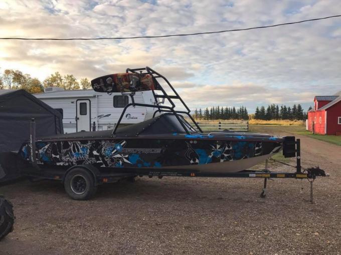

1994 sport nautique home made ballast system with 4 fat sacks . Great set up . But takes up all the room . Any aftermarket sacks that fit in or under or around places out of the way . . .." anyone been down that pathTags: None
There just isn't much room to hide water in that boat. A bag in the ski locker would work.
There is also a sack available that can replace the back seat.
If you want to add weight and not take up space then lead is your friend. It is a pricey investment but it's the best way to add weight without taking up space.
Not sure how experienced you are but for Wakeboarding you really don't need and weight to get a good wake from that boat. Wake is great without weight and just gets bigger and bigger as you add weight. Unless you are at the level where you are already doing big inverts, you probably don't even need weight.
For surfing you'll need weight. Get a Nauti-curl or make your own.
Yes that boat needs weight. I had the same boat. After dealing with sacs I got tired of the filling and emptying ordeal and went with Lead Footz. Had 600 lbs of lead in 50 pound plates. Each plate was no more than an inch thick and about the size 8.5 x 11. I stacked four plates under each outside two rear seats. 200 under each two rear seats =400 rear
then put 200 under the bow. The wake is awesome with this lead because it can go further back and in places the sacs cannot. Towing slightly more effort with the extra weight. But worth the ease once your at the lake. Although you are stuck with the weight all day but it's not a bad experience.
