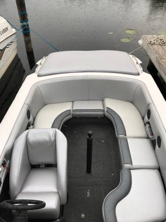

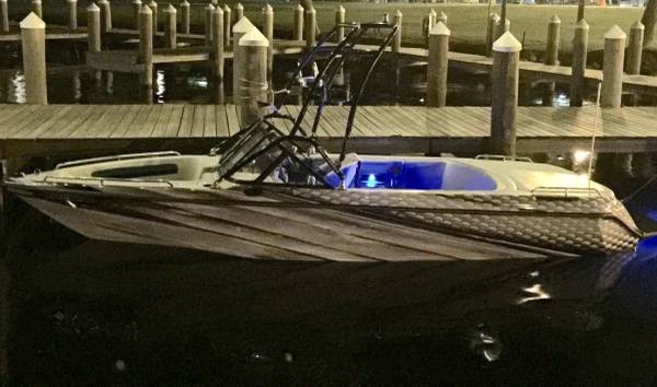

Newbie looking for advice. I'm looking at a 95 Super Sport. Boat looks to be in good condition with updated interior and an exterior wrap. Is there anything i need to know about this model, and what should I be looking for when I do the on water test drive and visual inspection? And is there any other models I should consider? Primarily a family/wakeboard boat. Would like to stay at or below $15000. Any help/comments are greatly appreciated! Thanks
Just normal stuff- check the fluids in the engine,trans and vdrive,it's under the middle seat in the back under a cover with a finger hole.Should start right up with minimal cranking. Steering should not be stiff,one or two fingers to steer,one hand at say 25-30mph to do a 180. Go over the interior,it's very expensive to replace. And why the wrap whats it hiding. Check underwater gear making sure it's straight,including the forward 3 turn fins,check hull by rudder and strut for damage. Ask and post any ? you have after looking at it.
