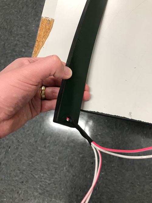

        #48
        Thejean, that's the only wire that needs to get into the boat. Everything else is just adhered to the gelcoat. As you can see it's not a large hole and is minimally invasive. If you need a referral from a Nautique dealer that has installed several of these so that you don't have to take my word for it, contact Marine United in St. George, Utah. They should be able to put your worries to rest.

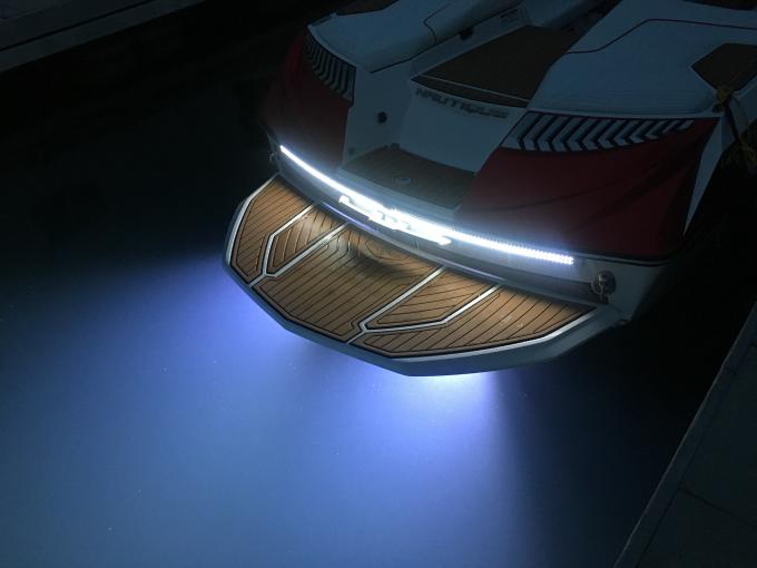

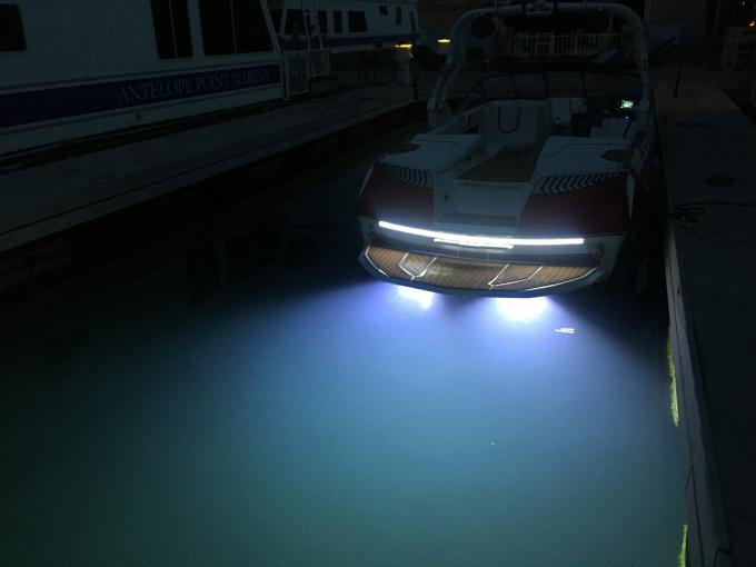

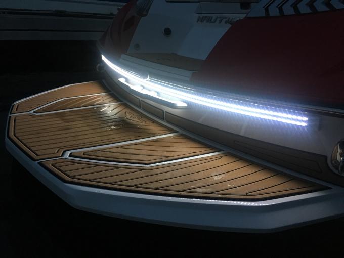

          #49
ID:	549545Click image for larger version
ID:	549546Click image for larger version
          There's a few more pics for you to see how they look installed on our G23.
