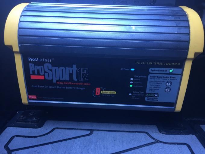

    Love it. Has an "inlet" by the drivers seat that you plug the end of an extension cord into and will charge / trickle.

      I have it on my 2014 g21...It does work pretty good. It came with the boat that I bought from prior owner...If you are handy you could install the same one yourself...
      It was not something I would have paid for from the dealer. But it is quite nice. On my old boat I moved the charger back and forth. This is better in the long run.

        I don't really use it at all during the season. I just use it as a trickle charger during the winter so I don't have to take the batteries out of the boat! Worth it IMO.

              I don't think it's a very worthwhile option. It's a built-in battery charger and unless you're careless, you really won't use it much. The only use case beyond that is off-season maintenance.
              I have a battery charger. With it NOT being permanently attached to the boat I can use it for my jetski, lawn tractor, old SUV I don't drive much anymore, etc. IDK how much it costs from Nautique, but I'm sure it's WAY more than a good charger from Amazon.

                Not sure how much the option is but I always add an in boat charger. Good ones can be bought for a couple hundred bucks and installation is fairly simple. Our G has the factory option and I love how simple and clean the install was... In short if your handy around the tool box it maybe cheaper to do yourself or if not its a nice way to keep up with batteries for sure. Undercharged batteries can over work the alternator. I like to keep mine plugged in while not in use but we have a lot of draw from stereo equipment and I feel like hot batteries sound better...Probably in my head! LOL!

                  List for the option in 2018 is $279. After discounting you are paying around $200. Well worth it for the convenience, factory install and warranty. My guess is if you and a buddy install a charger and it frys something, you are on your own. A factory installed charger goes wiggy, and you are covered. I have used mine a number of times this summer, once when both batteries were drained down - popped an extension cord in overnight and good to go in the morning. Honestly one of my favorite low-priced options.
