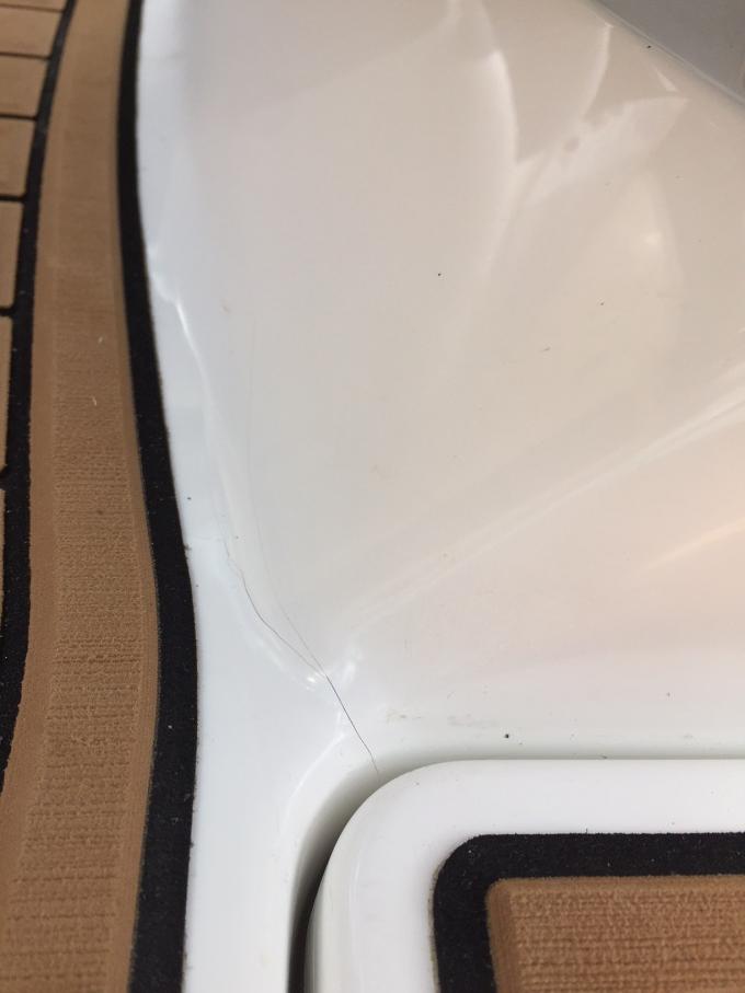

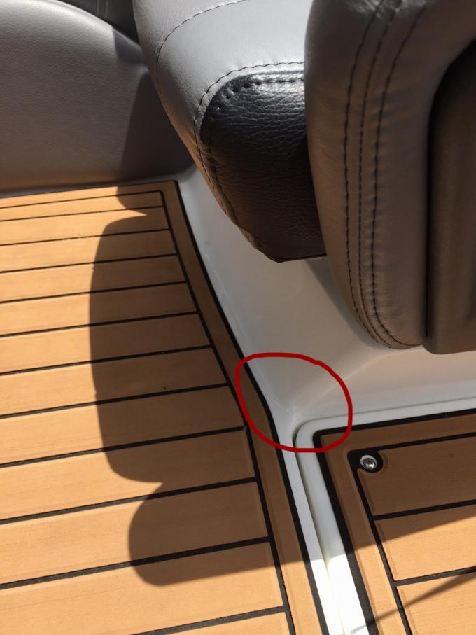

Before i flip my lid, on the dealer, how bad is this? Not just surface, you can feel it and flick it with your fingernail. 12 easy hours on the boat, bought new this spring.
That's just a crack in the gelcoat, not the fiberglass.
It should be an easy fix.Please do not PM me directly asking for advice on how to repair your boat. While I would love to help everyone, I simply do not have time to respond to all of the inquiries. Please post your questions on the forum, so that all of our members have a chance to answer.
I'd also highly recommend a calm approach to the dealer. Being polite and reasonable, but firm, and clear with your expectations will surely be the quickest path to a satisfactory resolution.
In any case, it sucks to have a crack in the gel coat on your new boat, but as Jeff said, it's just the gel and should be easily fixed - presumably under warranty, too, yes?
I have the same deal on our G. Like Jeff says its just the gel. I probably wont have it repaired.
It's not uncommon for a new boat to have a crack (or two or three) especially at curves and angles. They're super easy to fix and Nautique (in my experience) has no problem taking care of them during the warranty period.Previous boats:
2015 G23
2008 SAN 210
2002 XStar
1995 Sport Nautique
What do you think is causing the cracks? If flexing is causing the cracks, wouldn't the cracks just reappear a short time after repairing the gel coat. To keep it from coming back wouldn't the structure under it need to be reinforced for it to be a quality repair.
Work with fiberglass everyday , it flexes a lot but gel does not so if it does flex enough then the gel cracks giving the appearance of cracked fiberglass . It's almost impossible to not experience a few hair line cracks around round curves especially inside
