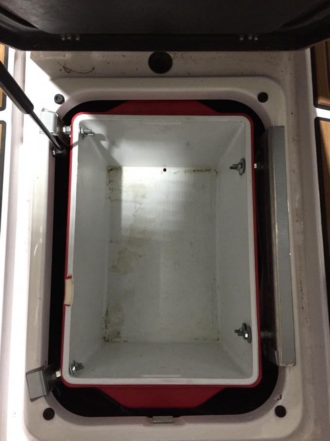

    ***DISCLAIMER*** This prototype #1. I know it's ugly. I plan on actually building a cooler that fits precisely and looks better this winter. But for now, this works!
    So to make this fit, I had to move both batteries to my port bench seat, no big deal, we all need more port weight anyways. Then the water hose from my seacock was in the way, I solved that with a 1-1/4" close nipple and 90. Next my center ballast pump was in the way so I built a bracket to move it ahead and down into the cavity where the valves are. Then I just had to build the brackets and use trial and error to figure out a height that the floor hatch would close tightly on the cooler top to act as a lid. I'm horrible at remembering to take pictures while I work but if you want to see anything else just let me know.

    Are you putting a cooler in this cooler?
    My complaint on the G23 is that the ice only lasts a day. I will be pulling the floor and doing spray foam in the winter.

      great Idea... while I don't need more that the Soft Cooler will hold, I be a lot of others appreciate the effort.
      I really like that the Batteries are in there myself... my port seat is full of Lead. LOL

        Unless that is a hole I see...if its bolted in place you are going to want a drain.
          That is a hole you see. It's not bolted in either though, it just rests on the lip of the hatch opening. Very easy to remove to pull the plug or work on pumps.

            Yeah ......it's cool if you want your pb&I to smell like engine.....lol. I kid...I kid. Pretty cool setup. I'm happy with the soft bag also. I'll get a bigger cooler when I bump up to a 23.

              Can you still reach your plug or will the cooler be easily removable?
