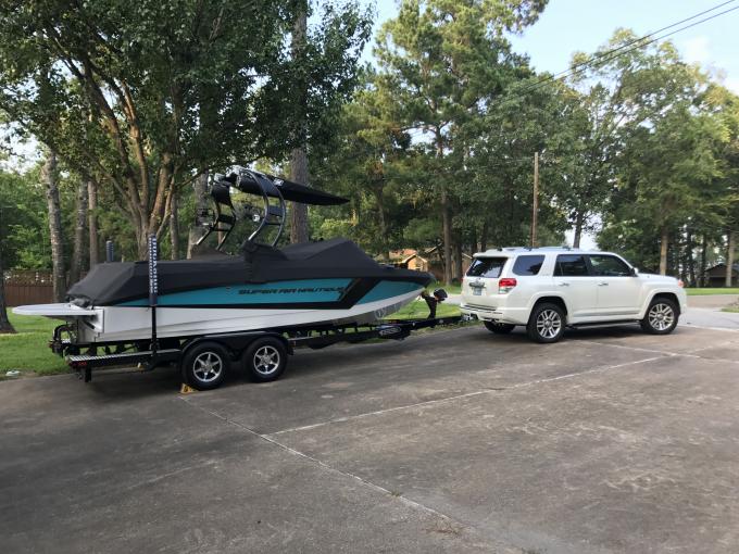

            Click image for larger version  Name:	IMG_3064.JPG Views:	2 Size:	76.0 KB ID:	526459
            I have a 5th gen and tow my 210 twice a year - I have air bags in rear - it does okay but would not tow anything heavier
