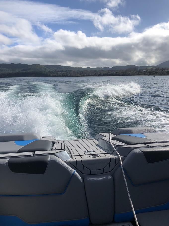

                It’s winter here in New Zealand so a bit cold to go surfing. I took our gs20 out to play with the wave on the weekend. This pic is at 17.2kph nss 0 Ncrs 5. I have 400 pound in back left locker and 400 pound where the bow filler cushion would go, all other ballast 100%. Just me in the boat, I could not get rid of the ridge in the middle of the wave, I even sat in the observer seat and it would not go away. Any suggestion? I tried different speeds and setting but still there.

                  I could be wrong but I think with 400 pounds in the left locker you have the boat listed too much. The GS20 does like a little more weight on the surf side, but I think 400 pounds might be too much. The NSS plate will be deployed on the starboard side (right) so if the boat is listed to much too the port side (left) the NSS plate will be partially out of the water and not do it’s job properly.
                  Try a more even weight distribution, with just slightly more weight on the surf side.

                    I agree with Evening Shade on this. I also think with one person in the boat that you have too much weight in the bow. If we are low on crew we actually take weight out of the front tank to sink the back end a bit more. Different story if we have four people in the boat. We have stock ballast only and our wake looks much better than the one in the picture.

                      Thanks for the feedback. Ill try putting the 400in each locker and see how it looks.

                        You will need 400 pounds in each rear locker and 250-400 pounds in the bow of the boat. Then let about 15-20% of the weight out of the rear factory ballast on the opposite side that you surf. I think that will produce a nice wave. When you do it take some pics and report back.
