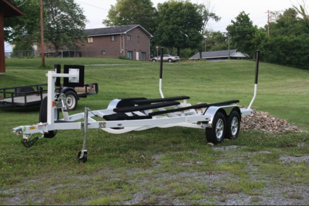

                      The roller is the problem, I have one on my 206 trailer and absolutely hate it. What works way better is the crashpad style bowstop like pictured below but taller stops preferably. The only down side of the crash pad is if it is the fixed style your cover may need to go on before you bring it tight to the carpet.
                      The work around is load exactly like Red describes, this is also the only way to load at a launch that does not allow power loading. A bit more of a PITA but you wont bugger up your rub rail/bow or scratch your hull, which is much more noticeable if hull is colored.
