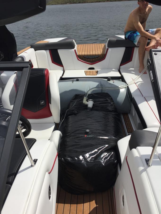

For my testing, I put them on the floor on the floor in the main area in an attempt to try and mirror my crew in weight. No ballast beyond stock.Last edited by LakePowellMan; 08-25-2017, 01:01 PM.
I tried the 17.5X17.5 (3087) and ACME added a .135 cup to give it more bite. RPM was nearly identical to the 3081 (18X18 .105 cup). I decided to stick with the 3081, but both are just HUGE improvements over the stock 17X17 when you have a 2:1 550 motor. It's not even close! The 3081 wins in performance (top speed/time to plane, etc) and lowers RPMs significantly across the entire range. Remember I did my testing at 5400' elevation but do the bulk of my boating at 3600', but wanted to do my prop testing at the highest elevation I would be boating. Big props goes to Jim at ACME. He worked with me on my testing and I shared my data with him and he's great to work with!Originally posted by RDT-G23 View Post
