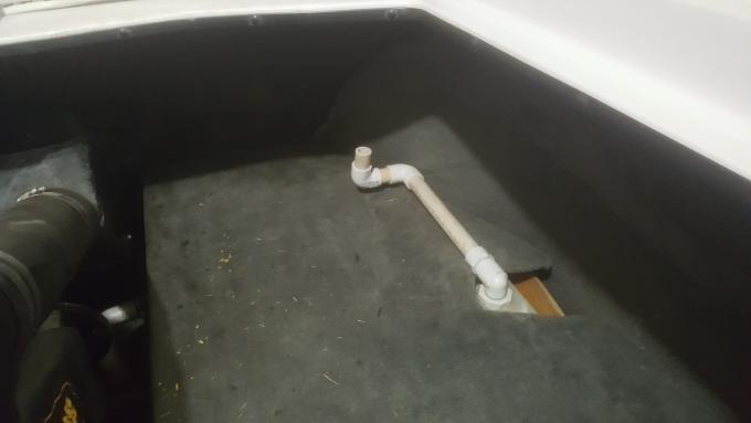

    New to the forum and new to owning a 2000 SAN. I have some questions about the ballast and how to make it work with some landing pads that came with the boat. I have a 540# and two 350# and some weird plumbing that comes out of the stock ballast tanks. The issue is that I just got it all in a bundle and have no idea how it goes back together.. The goal is to be able to have a decent surf wave.

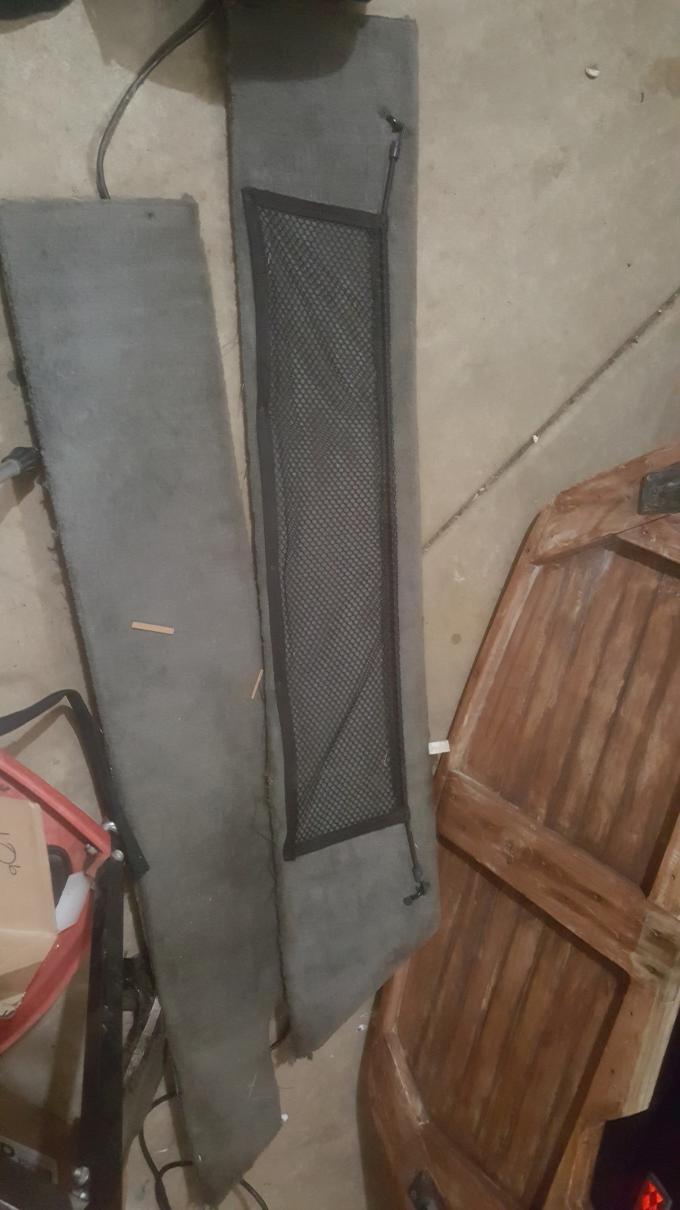

    Also, what are these planks for? I would have assumed they go in the back next to the engine but don't seem to fit right.

    Those planks are engine dividers, fit between engine and storage lockers. Two per side, one on top of the other one. Ballast-wise, it looks like unfinished custom overflow or fill line to me, depends on which pumps are you using.

      Cool, thanks for that. So you dont think the extra plumbing would be for the add on landing pad? Meaning is it possible to fill your onboard then keep ot flowing to the extra bags? Also, what do you mean by pumps Im using, like the pumps for the ballast? I have several but i think they are tsunami 500 or something, i can take a pic later.

        Erik, x2 on the engine dividers being those planks. They can be a bit tricky and depending on your boat are not interchangeable between sides. They need to stay with the side they were cut to go with.
        On the ballast pumps on board - you will either have original aerator style pumps (which is what tsunami's are) or may have been changed to impeller style ballast pumps. Impeller pumps are reversible, capable of fill and draining the tanks. Aerator pumps are one direction and you have to have a fill pump and drain pump per tank. I agree the PVC looks like either unfinished work or something custom no one is going to be able to help with without showing a lot more pics of fittings and bags.
        The idea the previous boat owner was going for was most likely a "piggy back" setup where you fill the extra sacs off the overflow vent of the tank and then vent the sac overboard for overflow. You're going to have to do some searching to see what kinds of setups people have done. Lots of info here on that.
