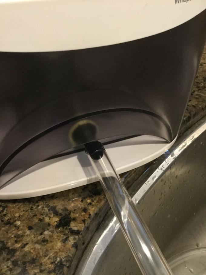

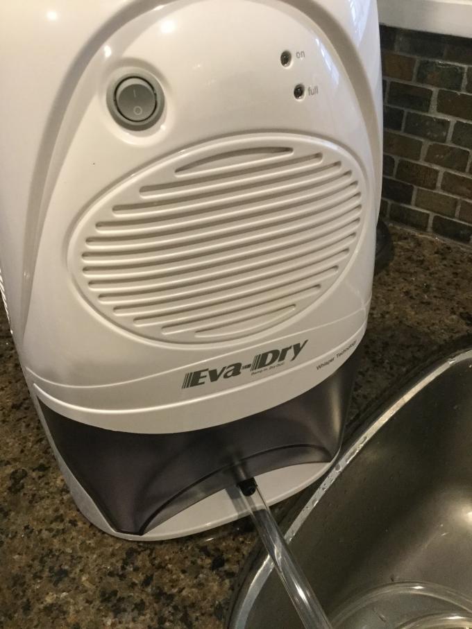

            It it will most likely be the humidity that damages your boat, versus the temperature, if you are covering it in an enclosure. Although both are usually dependent on one another, higher temperature often means higher humidity. Here is a dehumidifier solution, basically took an Eva-Dry dehumidifier and added a barbed fitting on the drip tray and a hose run through the drain plug. Amazon and Ebay for around $60. You never need to empty the drip tray. As per The Commercian Sewing website, Nautique covers, seal your cover vents and run the dehumidifier, less chance for mildew.
