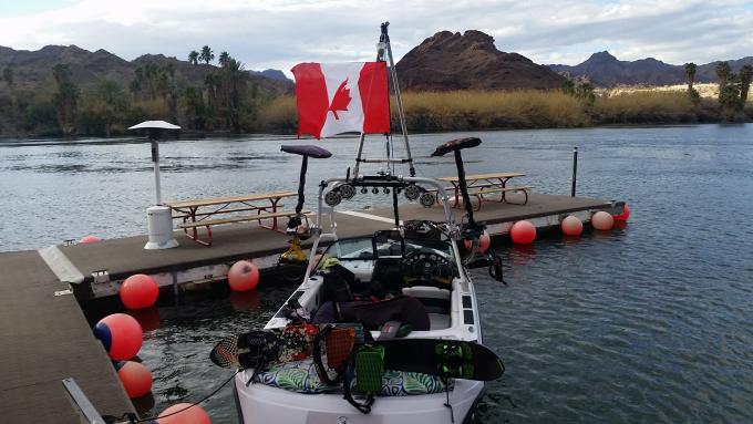

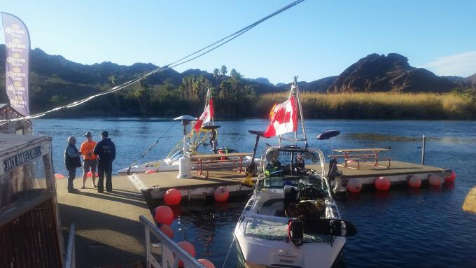

              BTW.... I did install the Fly High on a 1st Gen FCT. I broke my tower doing a doubles foil run from the Fly High!!!! Gave me an excuse to put a 2nd Gen FCT tower on my boat.

                I was wrong about my tower, it's actually a second Gen FCT, just like in your top 2 photos. So do you leave the fly high on and fold it forward and then fold your FCT down? Two person job sounds like.

                    Echo, laughing at your pic as there is probably more $$$ in those 4 foils then the boat itself!!
