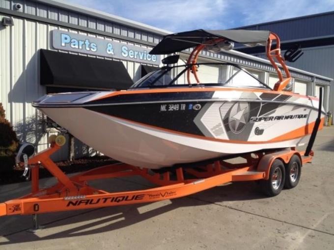

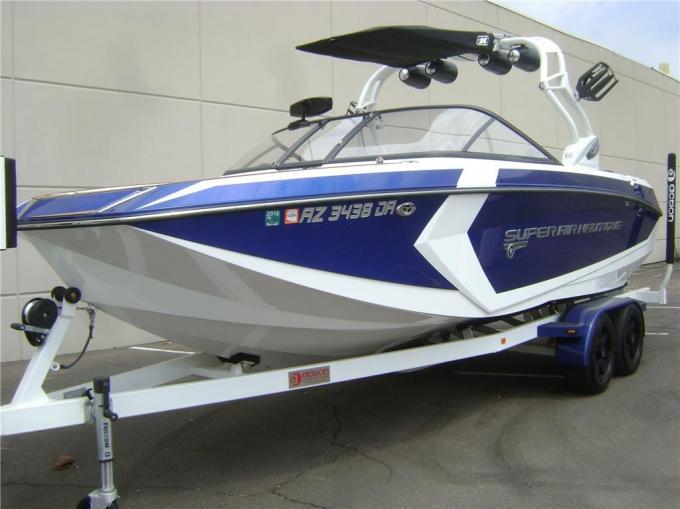

                          Originally posted by Wake.BC View Post
                          Can someone explain to me how such a huge boat can have so much spray into the boat? I’ve never had a problem with any other boat, but zero G experience
                          The original G bow is nearly flat almost like an old-school tri-hull so it doesn't really cut the water out front. In a head wind the water can bounce off and the wind will blow it up.
                          The 16 has a more protruding fiberglass flare on the bow that cuts the oncoming water. On my 16 I've only had spray issue onto the rear seats in a very serious side wind. Typical for any runabout.

                            Wow. Good photos Kmayotte. I didn't realize the difference is that big.

                              Yup. It also looks better on the water IMO. Less "whale-ish", more aesthetically pleasing lines.
