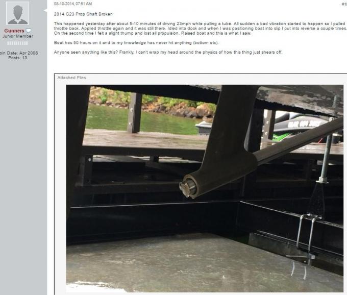

The only reason i would tend to stay away from a 2013...is uhh, how do i say this...the propeller shafts are known to break and leave you stranded....oh my that is a 2014....wonder what tranny?
https://www.planetnautique.com/vb5/f...t-issues/page8
