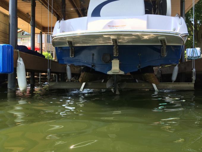

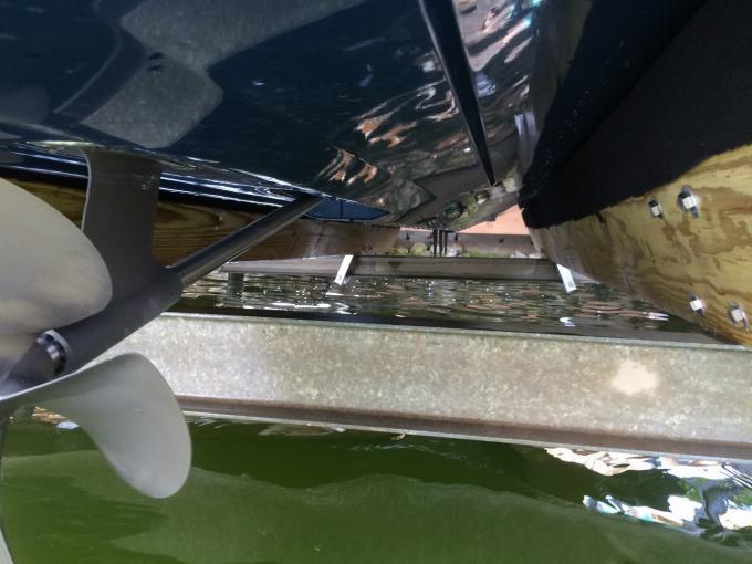

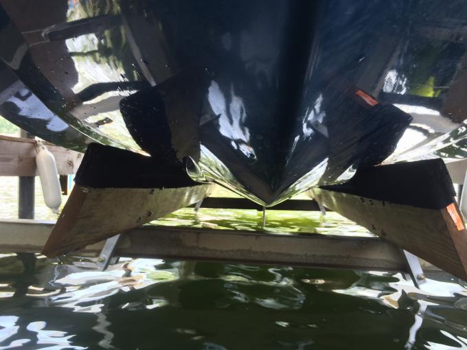

          I don't have your same boat, but here's an example of how we did our 211 this year. I assume you are talking a hoist type of lift here. These are angled single 2x12's. I tried to get the angle so the flat part of the 2x12 was matched up to the hull. They are a little closer in the front than the back. Like someone else said, the first time you do it, be in the water, go plenty deep and just feel around and lift a little and look and adjust until just right. Also, our prop isn't close to the cross member.
          Click image for larger version  Name:	IMG_2673.JPG Views:	1 Size:	46.2 KB ID:	505411Click image for larger version  Name:	IMG_2664.JPG Views:	1 Size:	50.0 KB ID:	505412
