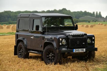

                                #60
                                Just thought I'd chime in.
                                In the UK the largest tow vehicles are rated at 3500kg max towing weight. These are much smaller trucks than those available in the US and are usually diesels. Think along the lines of Land Cruisers etc. There simply is no other choice. A guy at my marina tows a G23 with a Landrover Defender which would be considered the norm in the UK. A G is within that vehicles limit and hence deemed safe as far as we are concerned.
                                D.
