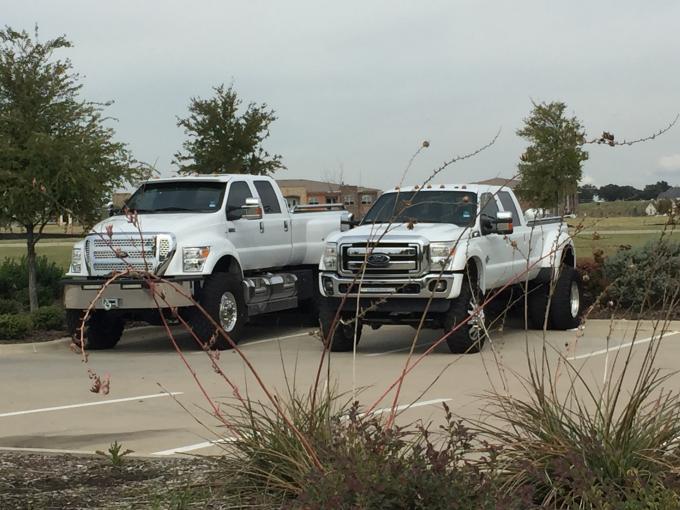

                  I was out around town this afternoon and came across these two gems. I guess it takes one of these two to "properly" tow a G23. The "little one" is an F550 and the big one is an F650. You really can't get an idea of how extremely large these two trucks are without a reference point, but I did not feel comfortable parking mine next to them and getting out and taking a photo.
