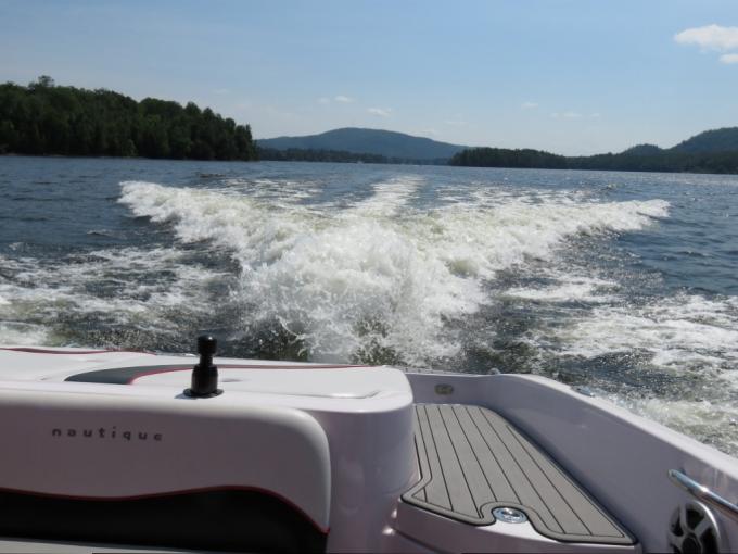

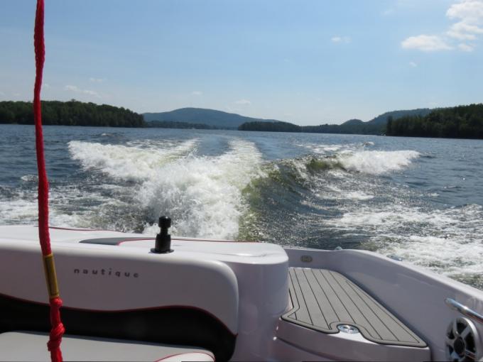

                          here are some pics of the surf wave on port side, has it is the hardes one to create. first pic with no surf suck gate, second one with suck gate on starboard side.
                          my surf setup (port) is stock ballast replaced by fatsack 750's in each locker (about 3/4 ful, say 1100lbsl), and stock belly (full, 350lbs), no bow..only extra poeple in the boat (sometimes heavy sometimes light), hydro gate in wake mode. 380 prop.
                          now i know some will say it is not that great of a wave, but it's merely the first year we are surfing port side has i had electrical issues last year and could not empty port side sac...so not too much experience, but both my kids are surfing with no rope on either side, and i am at the point of throwing back the rope soon.
                          hope this helps your decision.
