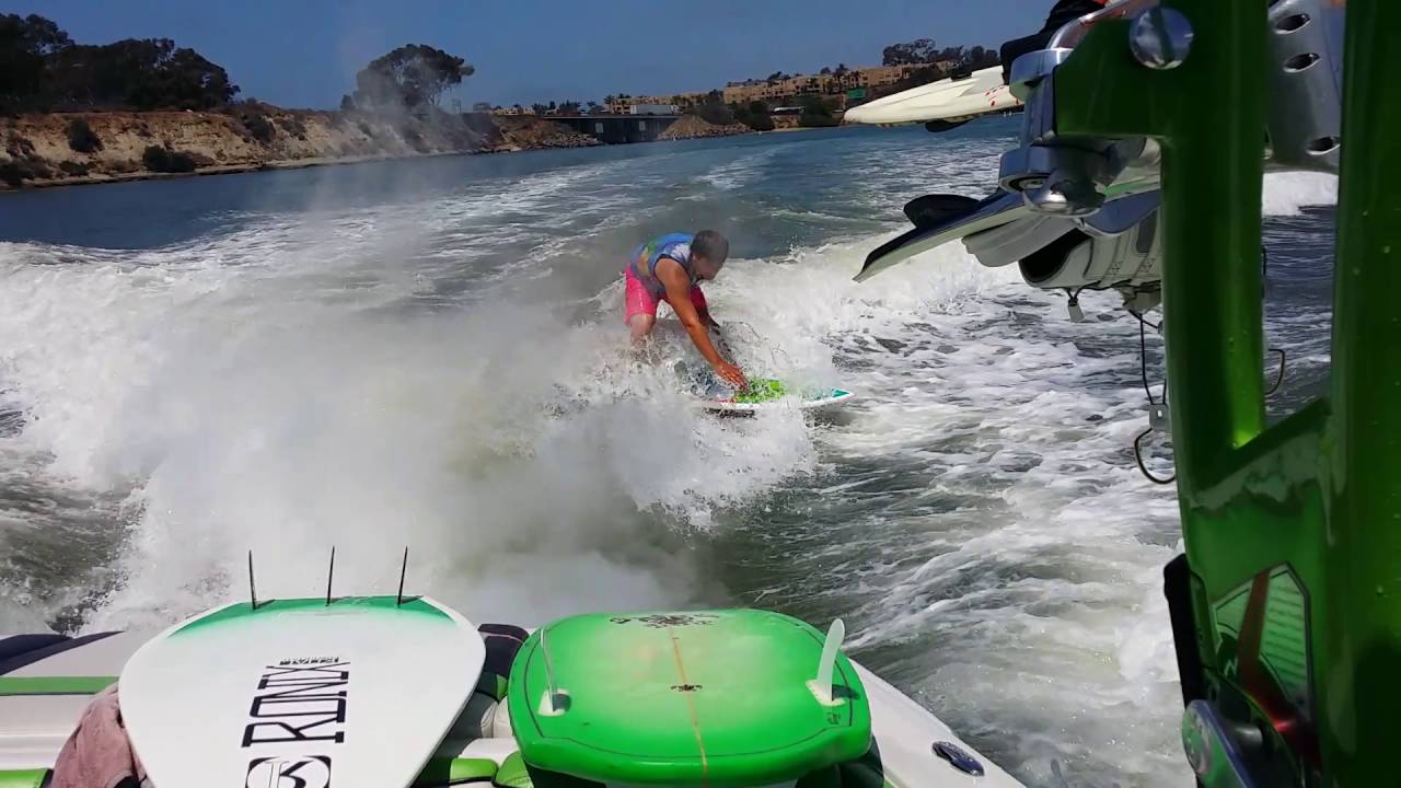

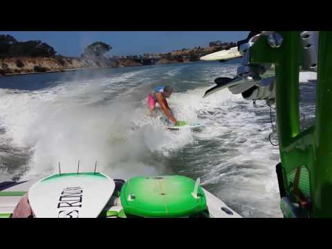

    Regular surfing exhaust BAD!! 210 SAN 2011
    First, FAE on order allready!
    Its crazy how bad exhaust and steam is on regular side wakesurfing.
    we slam the boat pretty good since water is shallow. 8'.
    Goofy = exhaust is underwater so not bad.

    I cant say enough positive things about my FAE on my 08 210.......After looking at your video I would say that is an excessive amount of exhaust and you may have a cooling water flow issue. Or that lake water is really cold...

      Ocean water is colder.
      If I don't slam the boat with water it does not smoke.

                    Update, FAE installed and used for a couple weeks.
                    It is amazing, we get no fumes and no steam.
                    Rooster spray is a little bigger about 15 foot off when going fast but no performance differences noticed.
